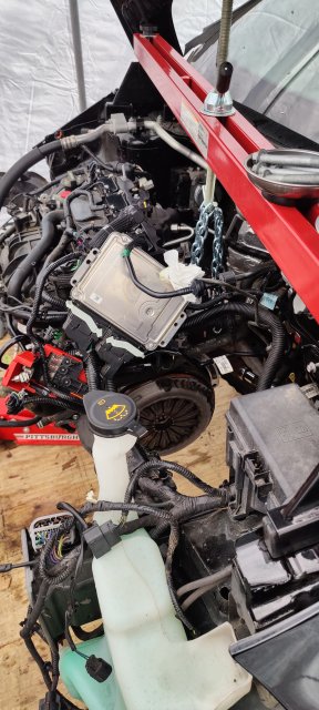

I'm looking into also wrapping the manifold and the catalyst converter along with the turbo lines with this stuff and then using metal zip ties to keep it all together.I definitely will post up some pics. Car currently looking like this. FORTLUFT Aluminum Heat Shield Barrier Ceramic Fiber Adhesive Backing 1/2"(12.7mm) x 12.00"(305mm) x 23.00''(584mm) https://a.co/d/fpv08tP

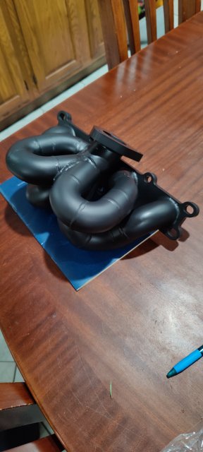

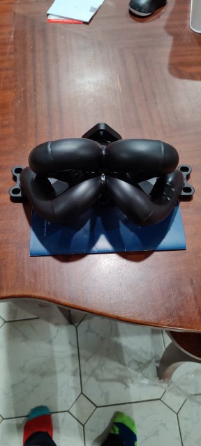

Yes I already had the manifold Cerakoted. Definitely sounds like we're going the same route on this one but I'm not painting the wrap I'm going to leave it alone. I didn't think about having it port matched though. Guess I'm bringing those parts to work on Monday before I bring them to get their cerakote. Perks of working in a machine shop😊

oh my that looks pretty...and mean.
