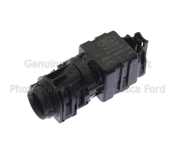

The part # you gave me is for the auto climate control cabin temp sensor, but it's not the blue one that goes in the passenger footwell. It's the round one that is mounted behind the dash to the right of the steering wheel (see pic below). The sensor you mentioned being in the passenger footwell is something else i guess.
