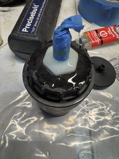

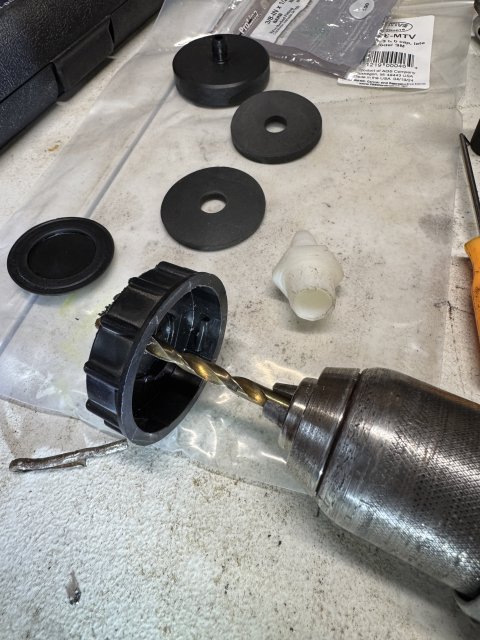

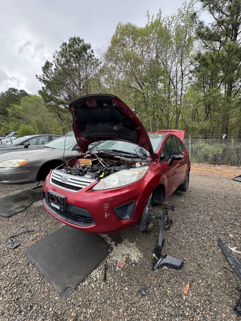

So, I hit the local junk yard earlier today and found the last cap in the entire yard on a 2013 Fiesta Sedan! [thumb]

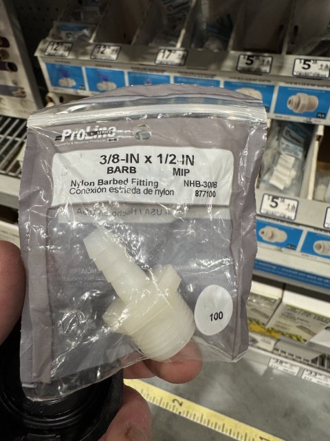

I hit Lowe's for 3/8in x 1/2in barbed nylon fitting:

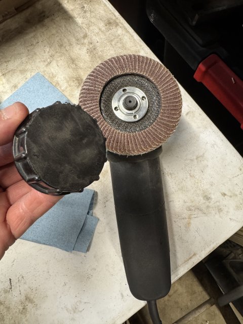

I used my grinder with a flappy sanding disc to smooth out all of the yellow raised lettering on the top of the OEM junkyard cap to make sure I've got a rough enough surface for the epoxy to seal to:

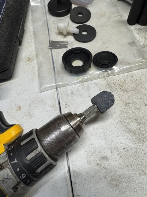

I drilled a large enough hole in the junkyard Fiesta cap to accommodate the nylon barbed fitting. You can see where I also ground down the threads on the 1/2in nylon side of the fitting so it would fit down into the cap hole tighter:
I finished off the hole with a circular grinding stone on my drill:
Then cut a tight hole in the OEM cap seal that would accommodate the nylon fitting and left the 3 little tabs that prop up the OEM seal in place on the inside of the cap:
This is the epoxy that I used to seal the nylon fitting to the OEM cap mostly on the outside with a little bit on the inside keeping it tidy as to not disturb the OEM seal:
I'm currently waiting on the epoxy to dry overnight before I can test pressurize the system tomorrow, but here's what it looks like now:
Basically all I did was remove the GM fitting from the end of the bleeder and I'm replacing it with an OEM cap that will fit on the end of the bleeder hose. This should make future brake/clutch fluid flushes a breeze if it works correctly!
As soon as the epoxy is dried and I can put this to the test tomorrow, I will update this thread with the results! [twothumb]

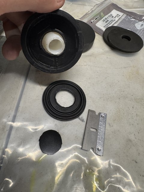

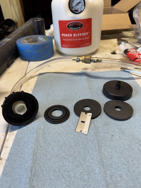

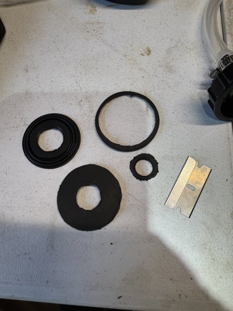

So as you could see in my previous post, I modified an OEM junkyard brake reservoir cap to accept the tube from the Motive Power Bleeder. Once the epoxy had dried on the OEM cap, I used the OEM seal that I had cut a hole in to accept the Nylon Barbed fitting that I picked up from Lowe's and did another dry pressure test using the seal on the left of the following picture:
Needless to say, the OEM seal didn't hold pressure on the mouth of the reservoir, so I decided to press on and make some more modifications to the system. Next, I cut the thinner rubber washer that came with the Motive GM 0108 Kit to fit the exact inside and outside diameter of the OEM rubber washer, taking my time to ensure a tight fit by tracing it with a pencil and slowly cutting it with a brand new razor blade:
I tried test pressurizing the system once again with the thicker rubber washer both dry and wet(a little bit of brake fluid on the surface) with no luck. I was still losing about 1psi per minute. [?|]

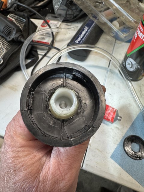

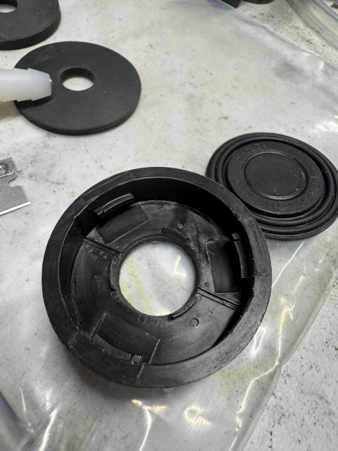

As you can see in this pic, the inside of the OEM cap has channels top and bottom as well as a couple of small holes at 11 o'clock and 3 o'clock:
I decided to use some RTV to fill these channels to ensure no leaks were happening between the top of the washer and the OEM cap, giving the RTV plenty of time to dry:

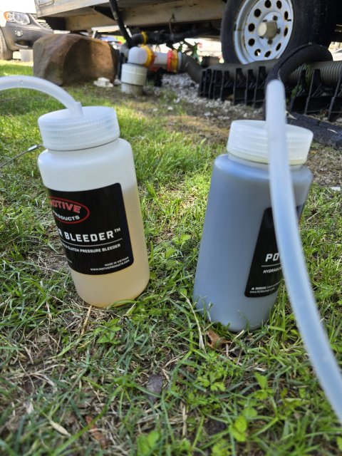

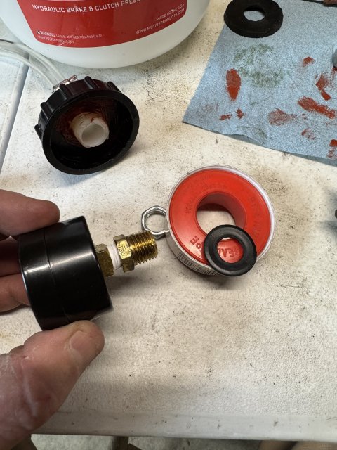

I ALSO decided to remove the 3 hose unions between the pressure bottle and the OEM cap to ensure that I wasn't losing pressure there either. Now, my OEM cap is DIRECTLY connected to the pressure bottle. Fewer hose unions = less potential for leaks.
Fewer unions was the FIRST reason for removing the gold fittings that were inline of the system. I've got a SECOND reason that has my blood boiling, so read on and I'll explain! [?|][?|][?|]
To be ABSOLUTELY certain that I cover all of my bases on this, I removed the pressure gauge from the bottle. While it did have teflon tape between the gauge and the fitting adapter, I put new teflon tape on it(ensuring the that teflon tape was wrapping the threads in the correct direction), used a little bit of RTV between the rubber/metal washer that sandwiches between the bottle and adapter fitting, as well as some extra teflon tape on those threads to make sure everything is completely sealed:
Now that all of that was out of the way and everything was back together, I did yet another dry pressure test and continued to lose about 1psi of pressure per minute.

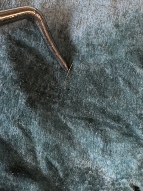

Let me explain the SECOND reason for removing the gold barbed fittings in addition to having fewer unions in the system. While inspecting the fluid that I have in the reservoir, I found MULTIPLE small gold slivers sitting at the bottom of the reservoir. I KNOW that they were not there when I started this project, so the only place the could've come from is inside of the pressure bottle. Needless to say, if I had not caught this, the bleeder NO DOUBT would have pushed these gold slivers into the hydraulic system, likely taking out O-rings, thus I would've had to likely replace the clutch master, slave cylinder and/or brake calipers since they all contain O-rings. :mad::mad::mad:

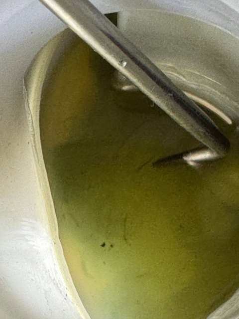

My pick tool in this picture is pointing to one of the gold slivers, which is a little difficult to see since they're so small:
Here's one of about 4 of them sitting on a blue shop towel once I fished them out of the reservoir:
Needless to say, I have gone ABOVE AND BEYOND to try to make this piece of shit Motive Pressure Bleeder work and I suspect that it is actually leaking from the pump handle itself. Yes, the top is screwed on tight and yes, I did lubricate the pump shaft with a very light oil.
I guess the first indication of trouble should've been when I originally took the bottle out of it's box and unscrewed the top to make sure the inside was clean, a small piece of plastic fell out of the bottle. :mad:
Lastly, this product says "Made in the USA" on the sticker and while I'm not sure if that's the truth, my guess would be that it was "Assembled" in the USA with parts from outside of the country, but who the hell knows. [dunno] These guys couldn't even stick the label to the bottle so it wasn't crooked:

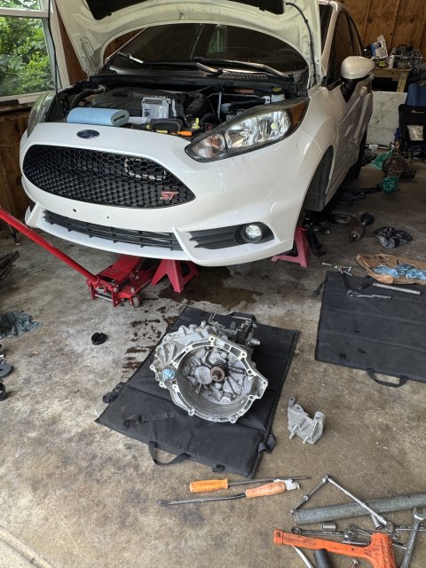

Finally got my car back on the road after the clutch slave failed earlier this Summer. Most of you have seen my struggle with the Motive Bleeder a few posts back. Needless to say, because I couldn't get the Motive Bleeder to work, my clutch slave ended up failing, costing me a new clutch slave, new clutch master as well as a new clutch. (I had a 5,000mile roadtrip to Arizona the week after I had the issues with the Motive Bleeder, thus not being able to complete the clutch/brake fluid change interval for a few weeks.)
Out comes the gearbox....
I also snuck some new upgraded SuperPro A-arms in while I had the gearbox out, since I ended up destroying the OEM lower ball-joint boot on the stock A-arms while removing them, so that I could remove the axle shafts from the gearbox:

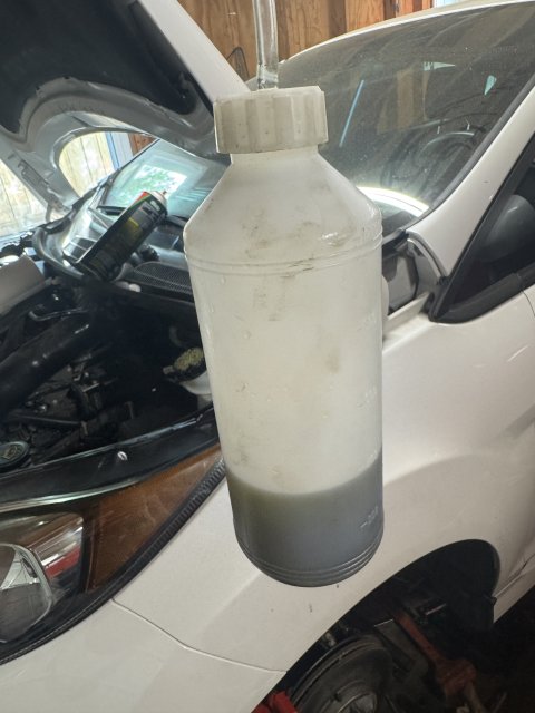

THIS is the Power Bleeder that I recommend using over the Motive Bleeder. This is the AGM Brake Pressure Bleeder which hooks up to an air compressor. I used my little 3gal pancake garage air compressor to pump this thing up to 5-10psi and it holds pressure great. This thing literally made bleeding the clutch and my brakes stupid easy! [clap]
Link to Product: https://www.amazon.com/dp/B08W2R73VJ?ref=ppx_yo2ov_dt_b_fed_asin_title
As you can see, it's got an air connection and valve that you can crack open to pressurize the bottle, as well as an air relief valve should you accidentally over-pressurize the bottle. This thing held pressure beautifully and I literally had my clutch and brakes bled correctly in about 15mins. [twothumb]
This is what came out of my brake lines. Definitely needed to do this service!
