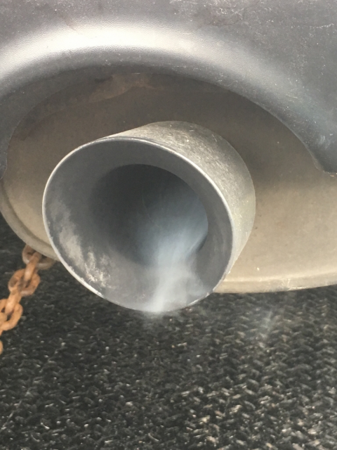

Update: I replaced the spark plugs and coils. One cylinder had a spark plug that was a little mosit and smelled like gas. The car cranks for a few secs before starting but it sounds rough. Idle is high and maybe 30-40sec later it will stall out. I've read multiple threads saying it might be the low pressure sensor so I got a replacement part for that and will be working on it tomorrow. However, I did notice a gas smell as I was trying to start it and looking into the exhust a little bit of white smoke was coming out so im not entirely sure what it could be.
White smoke usually is an indicator of Antifreeze * i hope it isn't for your sake! Keep us up to date
yeah I was thinking that too but when I smelled it. I was smelled gas and not coolant but we'll see how it goes. Some threads said it could be a bad fuel injector? could possibly make sense since one spark plug had some gas on it and code was throwing out cylinder one misfire.
An injector that is leaking down/failed* check the oil level also and smell it for gas. If it smells like gas time for an oil change to avoid bearing washout.
