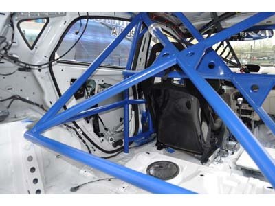

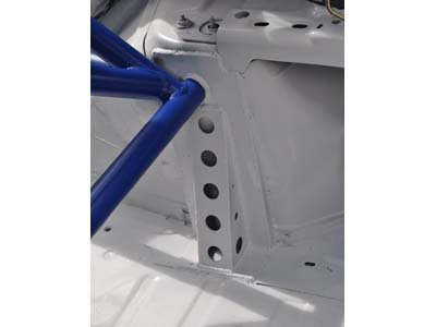

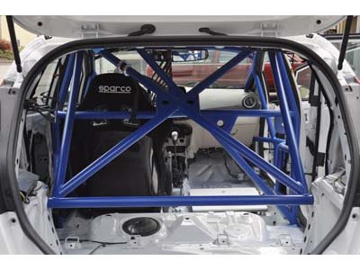

The B-spec Eibach/Ford Racing kit required the cage to be tied into each upper strut mounting point. Without the cage reinforcement the shock mount location would tear away.
With that, a divorced setup is still a viable option in B-spec classing and i am actually building that exact setup right now.
This is not 100% correct however the body at the top rear shock mount was modified to provide support.
The rollcage was only tied in to prevent inward bowing of the body.
When Eibach used my car test a streetable version of the B-Spec setup, I drove the B-Spec setup without mods for about a month.
For use here in the US, to prevent lawsuits, it was decided to relocate the rear springs back to the twist beam but then the project was canceled and not sold in the US.
BTW: This is where you can get the B-Spec coilover set.
https://www.motorsportandperformanc...ford-racing-fiesta-b-spec-race-suspension-kit
You literally state exactly what occurs.....the body bows inward causing the sheet metal to tear.
From what i have personally seen the only thing done to the rear towers is the cage tie points and the dimpled reinforcement plate(which happens to be under the grey rule for backing plates). What other modifications have you seen?
