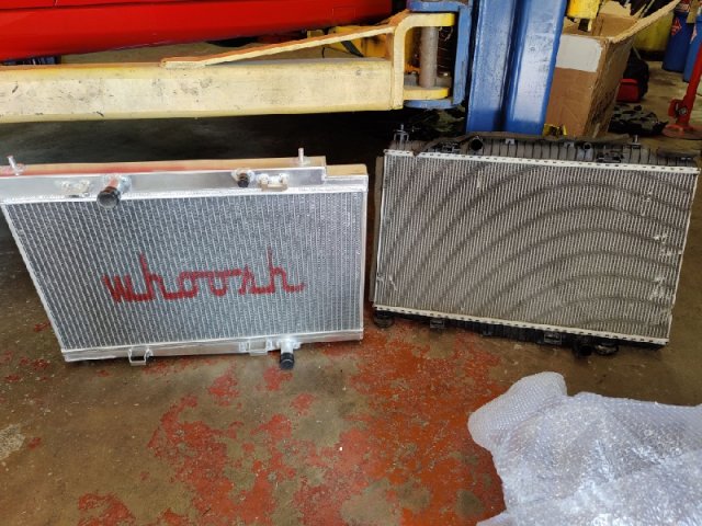

Alright, I had time this weekend so I went to my local auto hobby shop:
I basically followed the Mountune instructions in order to get the fan and old radiator out (fan went up and out, radiator down and out). iI'll spare the pictures leading up to the removal since its the same.
It took me about 2 hours taking my time to get the old radiator out.

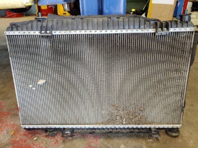

My Dirty old Radiator

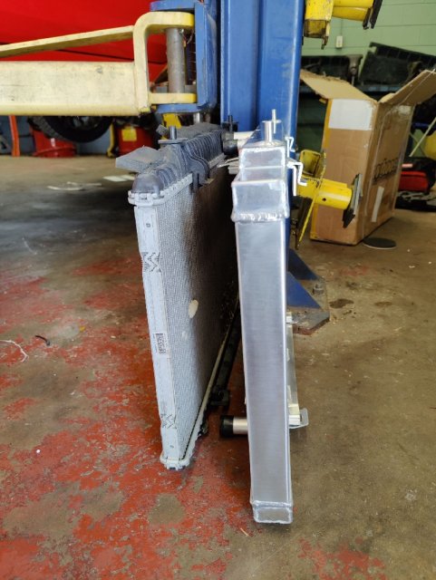

Whoosh next to my old one, i did the damage to the old one but notice the minor fin damage on whoosh probably due to shipping.
Definitely fatter.

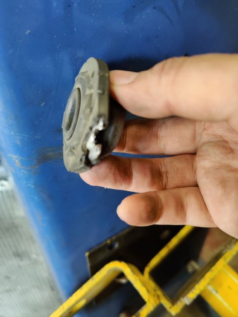

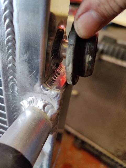

my first fitment issue:
solution: get pliers and tear off a piece. It worked.
Now the unfortunate news: This is not a drop in procedure like Mountune. I repeat, NOT DROP IN. I spent a good hour gradually working whoosh's radiator without damage, but once i got to the point of putting the bottom through with the rubber/metal grommet I noticed I couldn't make the height clearance to attempt the aluminum tabs w/ the ac condenser. And boy I tried...

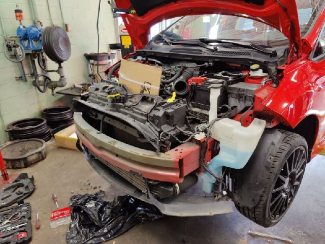

At this point I knew I had to take off the bumper/crash bar for more clearance. I wasn't ready for this so I loaded up the mishimoto radiator instructions on Youtube and followed it step by step, pretty slowly. Anyways, the hobby shop closed so I wrapped things up and my FiST is now in the state below. Hopefully I can finish tomorrow.

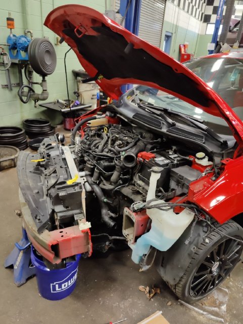

So I finished taking off the crash bar and I really was grateful for my lift, I just plopped the crash bar on 2 buckets and an extra jack stand for good measure. I actually recommend the crash bar route as I had SO much more room to work with, go this way and you are much likely to damage your radiators or ac compressors.
