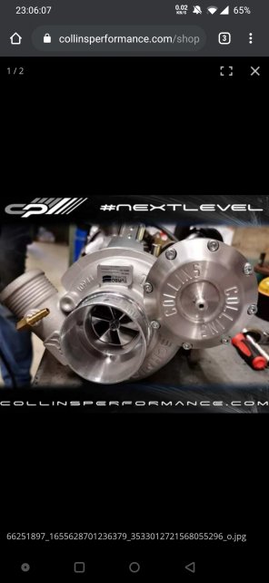

Anything else you suggest? The CP5 kit looks amazing, i'm going with Mongoose Decat + Injectors + Itg Intake + Airtec Stage 3 and their S280 actuator looks very very good [emoji846]

The Cp5 comes with upgraded wga so that's done πŸ‘ I was actually refering to a ported stock manifold also like you said... So the kit has it comes does 350bhp without a doubt due to the larger injectors... I can see maybe the upgraded cam and target to 380 with a custom tune?
