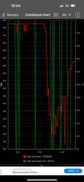

So the HPFS did not resolve the issue as expected so I really dug into the fuel system tonight. I decided to removed the HPFP and bench test it. When applying 12V it clicks once but nothing more. I’m thinking it’s locked up or not functional.
I also decided to test fuel flow from the lines as seen in the picture below. Fuel flows nice, smooth, and steady, which only leaves the HPFP as the final obstacle to the rail.
Picked one up to install from AutoZone and will post results. Attaching fuel rail pressure numbers for prosperity. The car will start after 8-10 seconds of cranking but sputter out immediately, as seen as the drop in pressure.

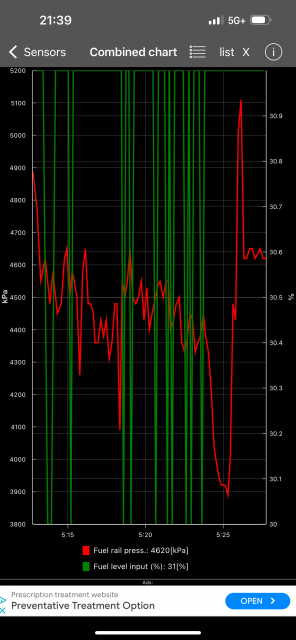

Today I learned a failed High Pressure Fuel Pump can cause a no-start due to low pressure. Everywhere I read states the HPFP only activates under load. But, the $250 replacement HPFP from AutoZone resolved my fuel pressure problem and I was able to get it running.
The vehicle starts and idles great, until about 30 seconds it stumbles and dies unless throttle is applied. A dip in fuel pressure can be seen in attached image when it dies. It’s throwing a generic P0001 code for a stuck open sensor or something similar. I believe it’s one of the cheapy sensors I replaced during troubleshooting (HPFS notably).
