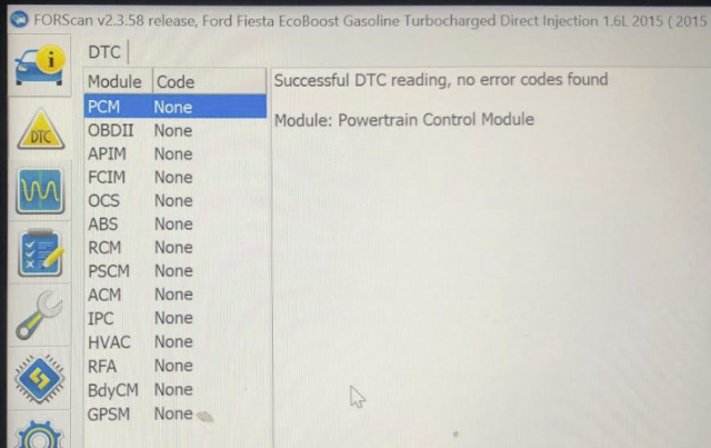

So, my adapter from Amazon came in same-day. How about that.
I got the OBDLink EX.

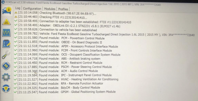

Got 'er installed with drivers. Installed Forscan. Read the data.... and...
It says no DTC. I ran the starter again until it stopped automatically. No code.
I guess, maybe tomorrow is looking like, check the timing belt and maybe do a last-minute fuel pump fuse/relay check. Or check voltage at the fuel pump connector.
I really think, if there's spark, spraying a 3-second blast of starting fluid into the intake should've made it stumble or do anything.
Thanks for the help guys, I appreciate the tips. Forgot to mention.

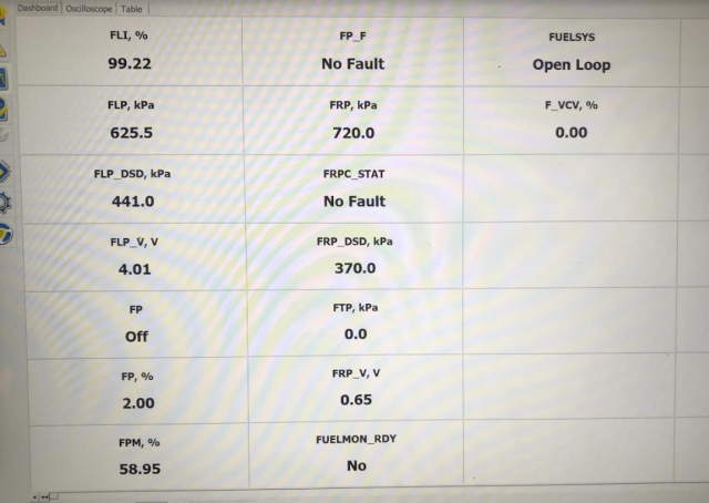

I added some fuel-related, I guess they are sensor tags, to the dashboard and did a real-time with the key off.
I do see, what says a 'low pressure fuel pump' value and a 'fuel rail pressure'.
I wonder if this is enough evidence to say that the in-tank pump is working normally and the injectors are firing?

I believe the ECU does monitor those parameters and should set a code if anything is out of spec. Should hear the injectors briefly fire once, just from opening the driver door on a cold engine. Lighted USB-C bore cams that plug into Android cell phones were relatively inexpensive on Amazon. (used mine to peep inside the low mileage motorcycle tank prior to purchase) Since you already have a spark plugs out, may just be able to stick a long strip of paper down there to see if it comes out damp.

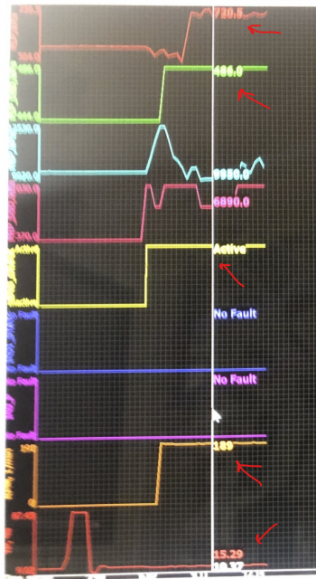

So, looking at Forscan... I added some tags, I guess they are called PIDs in auto terms? Reading about the fuel system. Low pressure from in-tank electric pump, high pressure from a second camshaft-driven mechanical fuel pump on the engine? Okay.
Found a tag for ENG_CRANK, and one for RPM, and TP, %.
Key on, throttle position shows a value moving with pedal press.
During a crank engine time span:
FLP, kPa is about 720 or 104psi. Low pressure pump result, it would seem.
FRP, kPa is about 10,000 or 1,450psi. Fuel rail, or high pressure pump result, it would seem. I wonder if these cars really have 1500psi here? Wow. Maybe I'm interpreting this wrong.
ENG_CRANK is Active.
RPM goes to 190 or so, that would seem to indicate, to me, that that crankshaft position sensor is pushing normal data.
Cam timing problem still on the table.

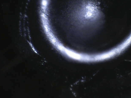

Time for a status update.
I suspect a mechanical engine problem. I think the timing belt's tensioner broke or changed position, or the belt jumped some teeth.
1.) A cam, visible through the oil cap hole, spins.
2.) The spark plugs appear normal to me, except for being wet with a fuel smell.
3.) The engine has a low-compression sound to it when cranking.
4.) Forscan live data displayed data values for RPM, low fuel pressure and high fuel pressure, while cranking.

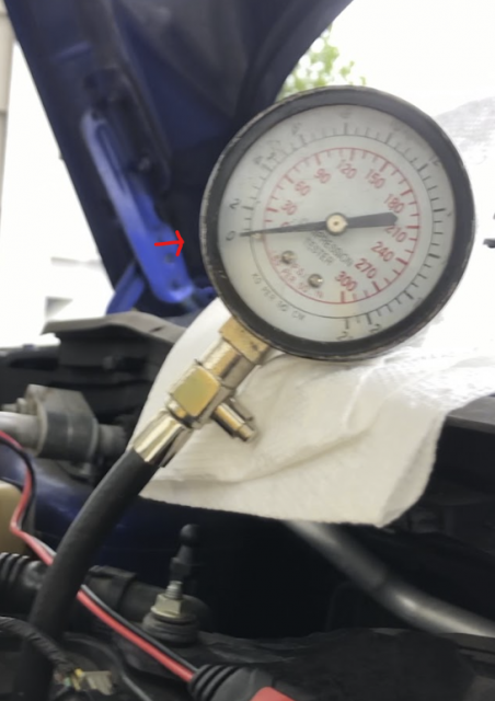

5.) Compression test on cylinder 1 was difficult to do, because the rubber type of compression tester line couldn't be tightened all the way, but it was still low and there was no puff when partially covered.

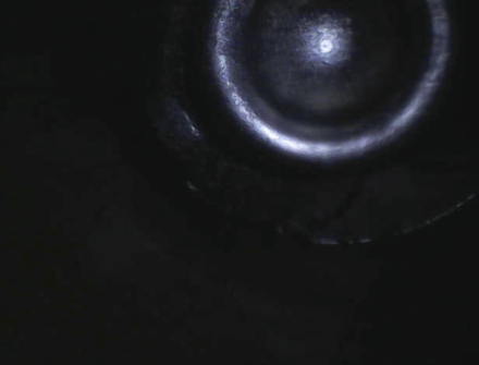

6.) I used a phone bore-scope and looked in cylinder 1 while cranking. No piston damage that I could see, but the piston was wet with fuel.
7.) There's a visible spark at plug 1, when the coil and plug are out of the motor, and grounded.
I plan to tow the car to another place where I can work on it in better conditions.
Next step will be to pull the timing cover and inspect the belt and tensioner.
Quick google search returns a non-interference engine for the DOHC 1.6. That would be nice. Edit: It appears to be an interference-type engine. Will possibly be dealing with valve train damage, if this is the case.
One final thought. It's strange, if there's spark and some fuel, that I don't get any backfires or pops. Makes me have second-thoughts about my testing.
Thanks, everybody.
Appreciate the suggestions from folks to get Forscan and the cheap bore-scope!
Pics here are of cylinder 1 and the piston dome.
Capri to ST

Good luck, sounds like you're doing a good job on diagnosis.
I just wanted to add that I'm fairly sure this is an interference engine, almost positive actually. When I was trying to figure out if it was I did see references online to it not being one, but ended up concluding that it was from other sources I found.Just passing that on for whatever help it is.
Here's a thread where I posed this question, and it was established pretty definitively that it is an interference engine.
https://www.fiestastforum.com/threads/is-our-engine-an-interference-engine.19479/

Whoa.
Okay. I agree... that sounds definitive to me. Appreciate the link and encouragement.
Well, that changes my perspective.
If it turns out to have jumped teeth, then the valvetrain might be damaged.
You know what's surprising... I was in the driver's seat, was backing the car up, and it stopped. No bang, or clunk, or grind.
I kind of expected to hear a mechanical sound if the valves contacted the pistons. Maybe that's not how it goes down.
