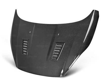

I've been thinking of getting this hood on Whoosh' site since it has hood vents. Only thing is I don't want to have to use hood pins as recommended. (Nor do I want to cut the OEM hood for vents)
Would this hood or a similar setup suffice to combat the increased volume?

We run this hood on our race car, it doesn't do anything for the temps. The only way to effectively combat coolant temps is a rad / oil cooler.
Also we don't run hood pins and its been fine.

I was wondering more for a scenario where the aftermarket crash bar was installed and the extra airflow causing lift. I think this hood would probably be good for stop and go traffic where the heat would be trappy. At a stop light since heat rises, these vents would possibly allow that heat to exit up through the vents while the vehicle is not moving.
