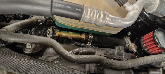

No worries brother- I meant the in line check valve (brass in my picture). The arrow has to point towards the valve cover

Hey dude sorry I forgot to get back to this. I found out why the catch can wasn’t draining or what I think the issue was, but I think Oil Sludge was building up in the can and wasn’t allowing it to drain properly. So we had to take it out and blow through the holes in order to push out the oil. I think you have to hold the lower tube and blow through the upper to push it out or vice versa sorry been a while since I did it.
