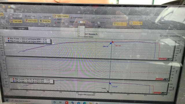

Went to the Dynojet last saturday and tested the final tunes for both 93oct and E50 on stock map sensor. Peak boost is right around 28.8psi.
93oct:
315whp 321wtq
E50:
372whp 369wtq

Quick Update: tested the 2 93oct maps I have with actual pump in the tank. Suprised to see the prior numbers on that map in which I was actually running E50 are nearly identical to just straight pump. Goes to show the real benefit of the Ethanol is being able to push timing and Boost. (Yes the dyno has a very dirty screen.)
