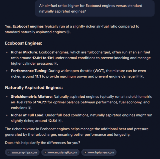

“Turbos run rich” - that’s not as much the case anymore with direct injection. Turbo engines traditionally ran rich with low compression ratio to prevent preignition. With DI, preignition is not as much of a problem because fuel doesn’t enter the cylinder until late. Detonation/knock is of course still a concern so it’s not all roses and you’re still not going to run NA-like airfuel ratios, but it does have an effect
4,221
2,757
The reason I air-quoted "need" is due to the vast improvements with air/fuel monitoring and metering versus 80s tech where it was non-existent and required periodic manual retunes. However the fact remains that they still need to run rich as compared to n/a engines.
The road-salt dust that is kept on the roads in varying amounts all Winter, part of late-Fall and early-Spring is incredibly efficient at rusting out hardware. In my experiences aftermarket exhausts components whether they claim to be 304 stainless just don't last, and opted to gut my existing clogged cat versus buy a new one bi-annually because it rusted out. Even though the naturally aspirated engine had modern MAF and Oxygen sensor technology, there was still a noticeable impact after gutting the cat.
