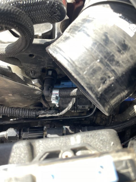

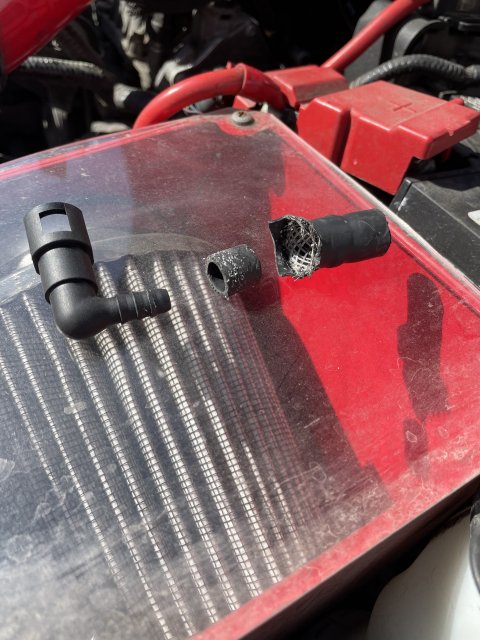

I have been running the Dizzy kit since around August. Install went fine and everything was working. About a week ago I started getting a faint fuel smell in the cabin. It progressivly got worse and was coming from the engine compartement. Visual inspection of the fuel lines did not show anything wet/dripping. Come Monday, the car lost all fuel during my commute. The supplied fuel line tore @ the L connector (right at the crimp) that goes into the high pressure fuel pump. I endedup cutting off the remaining end of the hose and reattached it using a new clamp. Dizzy (and Ron @ whoosh) are on the ball and have sent a replacement line. I am posting this as both a Kudos to them and as a FYI to the community to know that this can happen.
