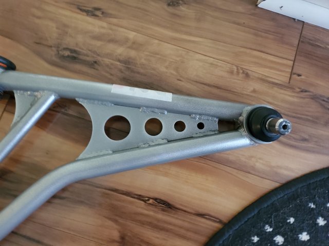

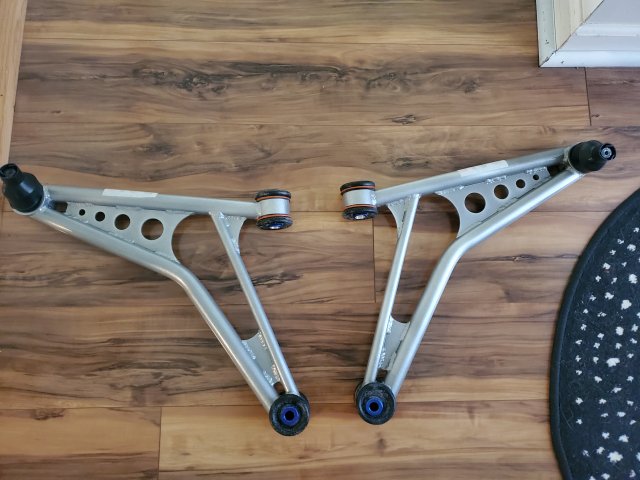

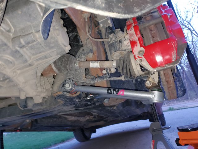

Finally have them installed and it made a huge difference (especially coming from broken ball joints). I don't have a full opinion yet because a tie rod end went (boot was damaged from brake heat) just as I finished with the test drive. But from my first impressions the arms gave a noticable improvement in steering feel, turn-in, and surprisingly traction was definitley improved. Once I get my summer tires on and tie rod end fixed I'll give an update but if my initial impression holds these should be a great upgrade for autocross.
Other than the cost and minor increase in nvh my only gripe so far is the quality of the welds, but it really only is a looks thing and I don't think there is anything wrong with the welds structurally.
Heres some pics, let me know if you have any questions.

Welds look consistent with the other two members who have bought these and posted. Not great. Hope they work out for you.
Are they substantially lighter than the OEM control arms? Curious if they are chromoly..

They are definitely lighter but not a crazy amount, pretty sure it's chromoly tho, it feels pretty much like a steel bike frame.

I don't care that the welds aren't 'pretty', but those truss plates should be fully seam welded, not merely stitch welded. [wink]

I had a class in high school that involved soldering, and I think the term our instructor would have used to describe the DNA weld would have been "bubble gum" -> "C"
Anyhow, I hope it works better than it looks, and thanks for taking one for the team!!!
