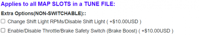

Reviving this thread…
Has there been a solution to eliminate permanent brake over throttle cutoff? Anyone tried a Forscan?
My 2014 FiST is a dedicated RallyX car so LFB is a must. I have a friend with two FiSTs, one for RallyX and one for stage rallies so I asked him how he addressed this, to which he said that removing the blue and white Cruise Control / Hill Assist plunger module above the brake pedal would allow for it. I patched a wire into it with a switch and then even pulled the whole module and I still can’t LFB for more than a few seconds before the throttle cuts off.
This can be disabled by your tuner, at least it can be by Stratified. I can't see why Adam (Tune+) or Jason (Dizzy) couldn't either
