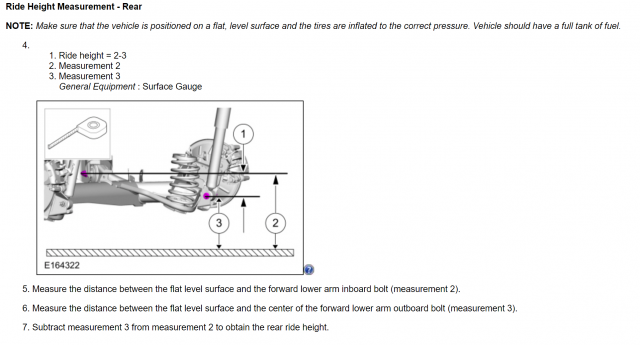

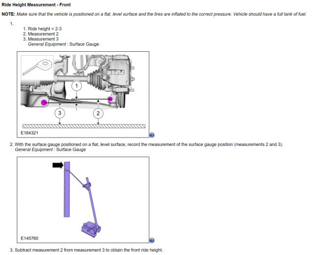

Check the pictures here - stock ride height with 195/55R16 snow tires (brand new full tread) on 16x6.5 ET38 wheels. No rubbing issues so far with either stock springs/struts or with my new spring setup, even with the RallyArmor mudflaps, although I did put shorter nuts on, so there's now about a minimum of 3/8" clearance:
https://www.fiestastforum.com/threads/feisty-the-family-car.30825/page-2#post-495305
If you look close at the wheel pics, you can see the low profile nyloc nuts I put on the front RallyArmor mudflaps - Nuts are 1/4-20 stainless 13/64" height from McMaster Carr. After installing them with some blue locktite for good measure, I dremeled off the excess thread and ground the ends smooth.
https://www.mcmaster.com/catalog/129/3595/97367A113
Here's the service manual method for checking ride height based on the balljoint and pivot heights measured from flat pavement. Factory tolerance is +/- 0.5 on the ST, so it's fairly loose. With my spring setup, mine measured almost nominal in the front, and a couple millimeters above nominal in back (but still well in tolerance)
View attachment 57439 View attachment 57440
I just ordered a bunch of those low pro nuts. Thanks for the link. Gonna do some measuring today thanks to all this info. Really appreciate this and everything else @Dialcaliper !!
