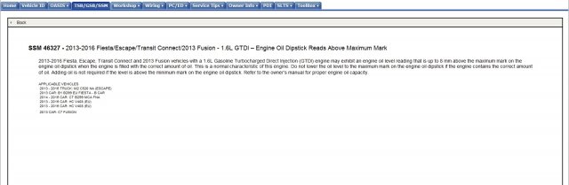

Not sure if this has been posted before but the 2014-2016 dipsticks read 8mm (5/16) high when the proper amount of oil is used.
Here is the Ford documentation.
Unfortunately this is a case when the Ford documentation is quite likely WRONG. I believe that when you fill a freshly assembled engine without any oil in it the amount used will provide a fill that is at the maximum mark on the dip stick.
The problem is that by design the 1.6 Ecoboost has a rather large volume of "trapped oil". My estimate is that it's between 4 and 6 ounces. Anyone who has read the manual should have seen the warning to NOT overfill the oil. Failure to adhere to this warning has the potential of resulting in a destroyed engine. As delivered when new my 2019 FiST was spot on at the Max line, so the factory knew exactly how much oil to fill a brand spanking new dry engine and I would bet that is what is listed in the owners manual. Folks, do NOT overfill your engine, fill it to the maximum line. BTW, I still get the Works for free so I have the dealer service the car. First change they filled the engine right to the max line. Second change 2 weeks ago and they put in 4.3 quarts by the metering dispenser and it was over the Max line by an eyeball 1/4 inch. Since I was still in the parking lot I talked to a service manager and they took the car back and drained out a bit of oil. Took the tech 2 try's to get it right but he did get it right. BTW, I'll forgive these kinds of mistakes at present because the service department is working at half staff due to the damned beer virus.

Scooter, SSM’s are not issued haphazardly. That SSM is specific to 2011-2016 Fiestas. NOT for your later model. Every time my dealer does an oil change on my 2016 ST it is slightly overfilled. I contacted Ford Corporate and they told me to follow the SSM.
I’m just repeating what Ford showed me through their documentation.
Sorry 2013-2016 Fiesta’s

I have a 2017, and if I put in 4.2 quarts I'm over the line. Four quarts puts me at the max line.
To be honest, I don't even measure out the quarts, I go strictly by the dipstick reading when I do my change. I dump about 3 to 3.5 quarts in initially, and then I just keep slowly adding until I get to the "MAX" line on the stick. [emoji6]
Scooter123 is 100% correct when he talks about trapped volume. And let's not conflate this with the SSB/SSM for 2013-2016 models. I cannot speak on that since I have a 2017. I have the cable dipstick but with the plastic end, which I believe is the upgraded version.
