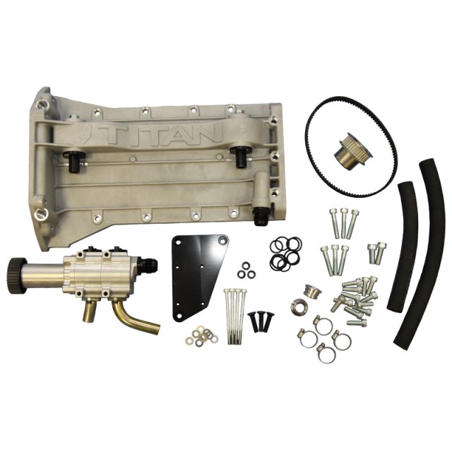

EcoBoost 1.6L Dry Sump Kit
14,917
7,360
That's actually a decent price if it functions properly, even with having to pay for the tank separately. [thumb]
Many others are $10K+ USD. [crazyeye]

Very cool product and very well priced. But I doubt this will do high numbers in sales. The amount of people that even track their fiestas is very small. The amount that push it hard enough to need this is even less. I haven't seen many people report oil pressure issues, I suspect the bigger benefit would be in being able to drop the engine lower in the chassis. but like mentioned above, this is probably meant for people using this engine in other chassis.

I have been considering getting one as a piece of mind, but there are couple things i don't like about it, it still relies on the OEM oil pump to pump the oil around the engine, this thing only has scavenging pumps, and if i were to get a dry sump it would be to get the oil pressure up at 8500+ rpm, which this thing does not help with. And it also replaces the aircon compressor, so that's not great either, for a road car anyways. Overall a good price for a nice product for some people no doubt, but not for me.
