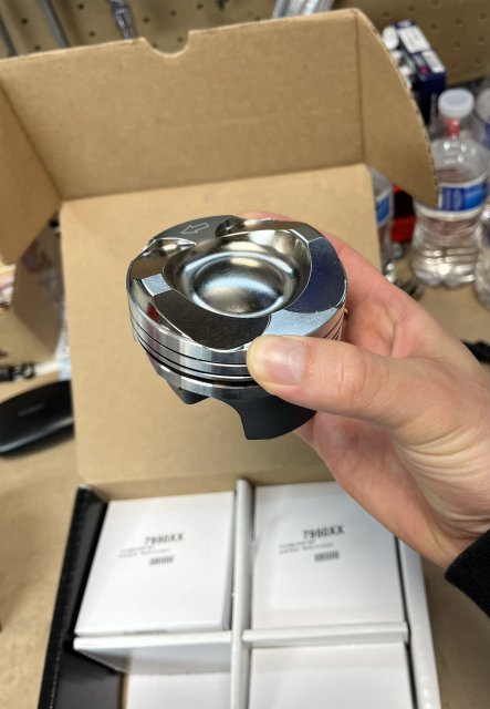

I did a compression test after my last race event, and I am down about 30 psi in cylinders 2 and 3. My thoughts are that the sleeve has failed at the common area between those 2 cylinders. I'm honestly not surprised with the amount of abuse I have put this engine through over the last few years. 60k miles, tuned at 500 and BT with 300whp+ at 20K. Plus over 1,000 WOT pulls for datalogs/tuning/development.
I ordered a brand new block from Ford for $286. The Wiseco pistons that I have on the shelf are .5mm larger than stock 79mm, so I do not really want to bore up on the brand new block already. I'd rather use those pistons on a sleeved motor that has some more "meat". So I came across a set of Diamond Pistons that are for the stock 79mm bore, so I scooped those up too. I'll hone the block to the piston size, use all the bearings, gaskets and keyed crank that I have ready and at least this will get me up and running again. I would also like to get some work done on the spare head I have, so that will be ready to install on this new motor. Some mild port work and Stage 2 cams are the goal for now.
Link to pistons: Pistons - Ford - 1.6L Ecoboost (diamondracing.net)
They seem to be a pretty good option and a great price. I'll get weights of both pistons soon.
