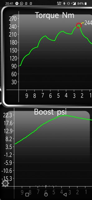

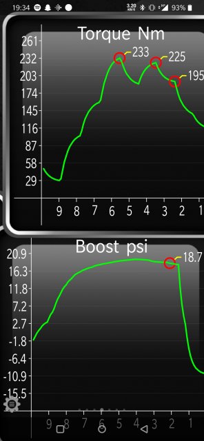

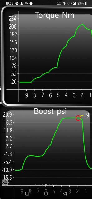

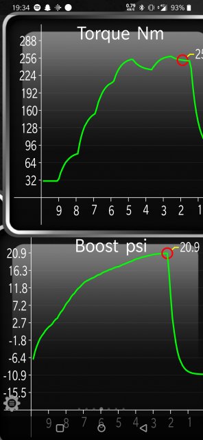

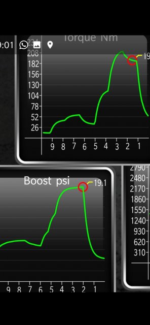

Hi,
Looking for some advice if anyone can help?
I was having some serious idle issues in the past.
The car was eventually diagnosed with a bad actuator and wastegate solenoid.
I got an OE solenoid and a forge motorsport actuator with an updated spring.
The car is finally now idling ok after a lot of troubleshooting.
The car is tuned to roughly a stage 1.5 for all the world, I am an exhaust system short for full stage 2.
The issue is, and I will attach screenshots, boost itself builds perfectly fine. The torque stutters as it builds. It will be more clear in the graphs. But is very very noticeable in the driver's seat.
I have gotten the actuator tightened twice since installed for fear the wastegate was flapping. But I'm limited in where I live in ireland for getting this to pros to properly review.
But for the now, I'd just love for this to be resolved.

I got the 13psi (purple) spring which is the next one up from stock spring. I brought the car to a local tuner who then mapped it for the new actuator.
It's strange because boost builds and holds perfectly. It's just the torque isn't smooth and drops off quickly.
Last week I cleaned panel filter and tightened all boost clamps too.
I also had a smoke test on the intake system to see was it sneaking out of somewhere that wasn't obvious and there was nothing leaking.
I've had the preload adjusted twice since install. The fear is over tightening it at this stage.

Here is a little screen recording of 2 6th gear pulls.
6th gear pulls? You should not be doing 6th gear pulls thats a good way to detonate your engine .
At least on this side of the pond tuners require pulls in 3rd or 4th gear. 6th is an overdrive gear and doing pulls in it bogs the hell out of your engine. Guys have blown their engines up trying to hit the turbo hard in 6th gear.

Sixth gear pulls for a video aside, unfortunately this is still happening in every gear.

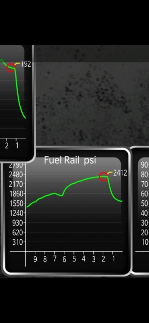

I will be honest forzda , I tried my best to get PIDs from the torque pro app, however even though I work in IT I gave up trying to figure it out due to laziness 😂

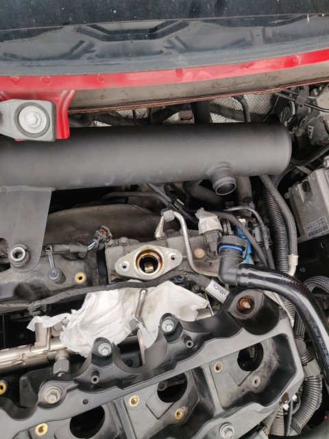

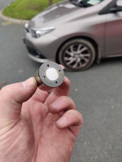

I can say with all honesty that this is thankfully now resolved.
I was watching all I could in graph view every time I went for a drive in the car. I could clearly see the spikes and drips then when lifting off and accelerating.

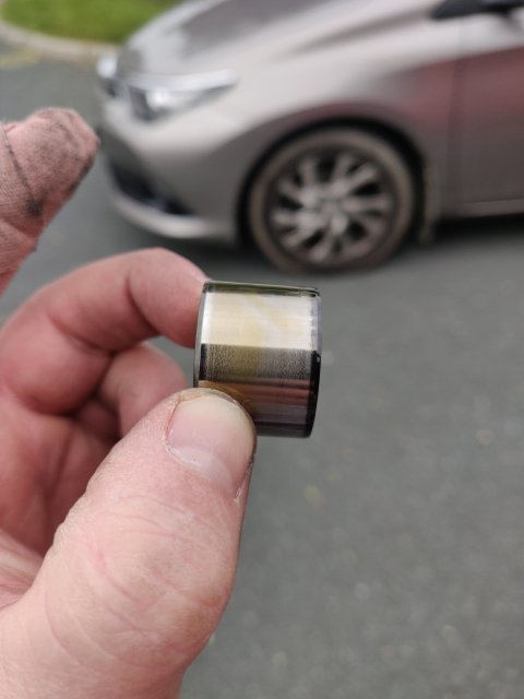

I had thought throttle body, but there was one thing that was in my mind all the time and for the sake of 25 euro/30 dollar part I thought I would replace the cam bucket/ tappet / plunger in the high pressure pump. In my mind it was a snake oil product, and when I removed the old (pics attached) this confirmed my belief.
But.
The car is night and day in the difference in how it was to how it is from one tiny little part. A part in my eyes didn't even seem worn.
With 75,000 miles on the clock on my car I would advise anyone I know to now with one of these cars to do it at minimum 50k miles.
The boost is as clean as it could be now with torque building as it should.
Thanks for help.

I've wondered; at what point is the CAM lobe itself, which contacts/actuates this tappet, too worn to function properly, even with a brand new tappet installed? [dunno]
#1663
331
145
#20
Hmmmm? Glad you got your problem solved for now. However, those cam followers are not “wear” items that need replacement, UNLESS there is a problem with the motor oil. I don’t know the quality/availability of synthetic oils there, but it needs more zinc for those high/pressure lubrication points. What oil you running?
