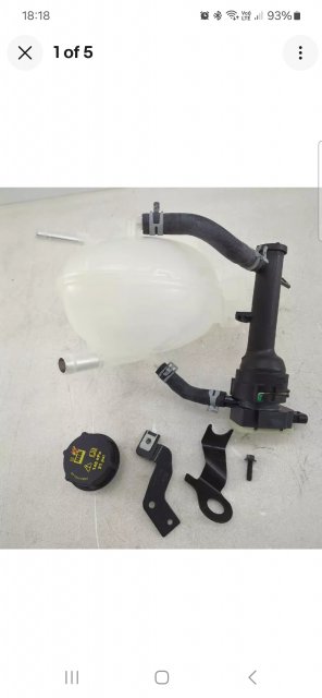

the problem is finally due to the lack of the coolant level sensor, the software was made but nothing was physically installed. Now that I have the pieces, I still have to know how the cables are connected, can someone help me?
