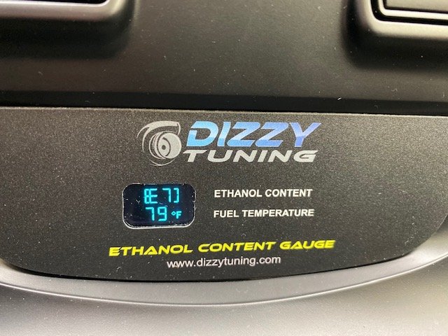

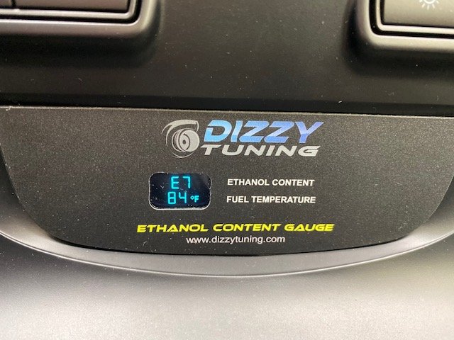

I finally finished the installation of my Dizzy Ethanol Content Gauge from Whoosh Motorsports. It’s straightforward and the instructions are accurate. If you have the MeLe Battery Box (like me) you’ll need to move the 3D printed bracket a little higher up (on the ECU cover) to prevent contact with the shifter linkage. I fished the wiring harness through the firewall using Symposer tube. I accidentally yanked the connector (that attaches to the gauge dongle) off the end of the harness while pulling it through the firewall. Instead of trying to slip the pins back in the connector, I simply stripped all the wires and spliced them together at the gauge. Everything hooked up nicely and I really appreciated having a complete kit that didn’t require a trip to the store. The gauge is clearly legible and doesn’t clutter up the interior. It’s well thought out and extremely easy to install when following his instructions. If you have any questions about it, let me know. Here are a few pics:
#6540
162
62
Do you have an empty cubby in the center?
It actually sorta clipped into the center cubby but had gaps at the sides. I decided to just put it where it is now since it doesn’t need to be looked at too often. Decided to put my radar detector interface button in the center cubby.
