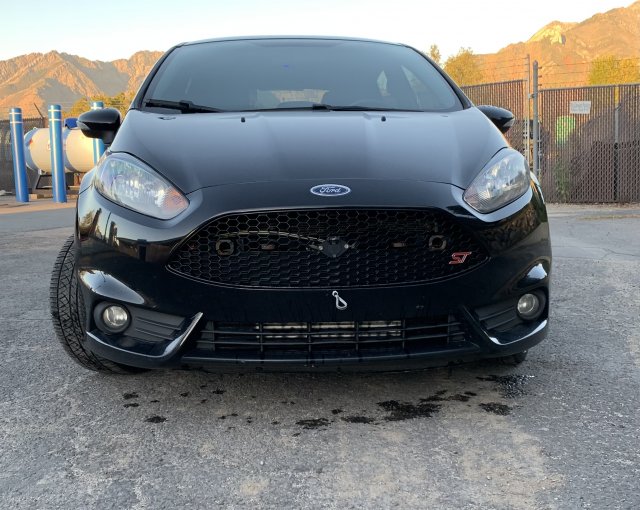

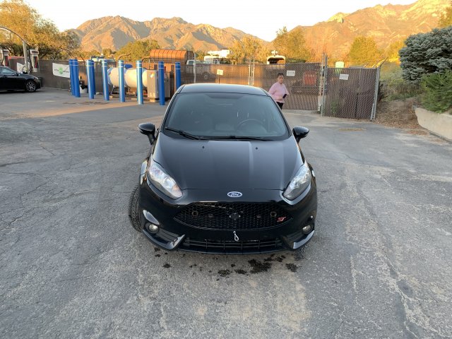

I am pretty sure it is the blue ox. I used the ready brute tow bar which has the surge braking system.
you do have to modify the bumper cover, you will need to cut holes in the grill for the safety chains, the Clevis for the tow bar attachment and a spot for the lights. I will post a picture of the front of mine so you can see.
The install is not difficult - but it is time consuming and tedious at points.
