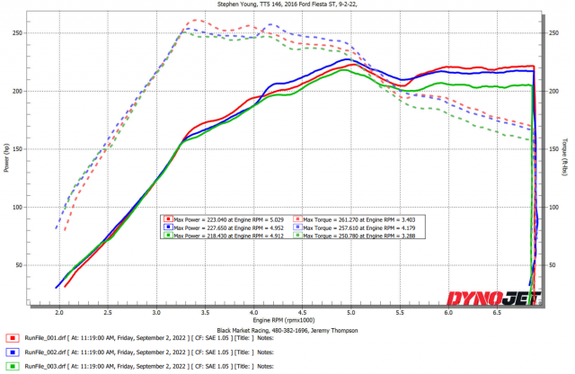

Got all Dyno'd up and certified for the championships. Detuned the S280 to a flatish ~225. We have to be under 233 with our weight of 2750, and we figure the dyno in Monterey will read some higher as the air temp and the elevation will be lower.

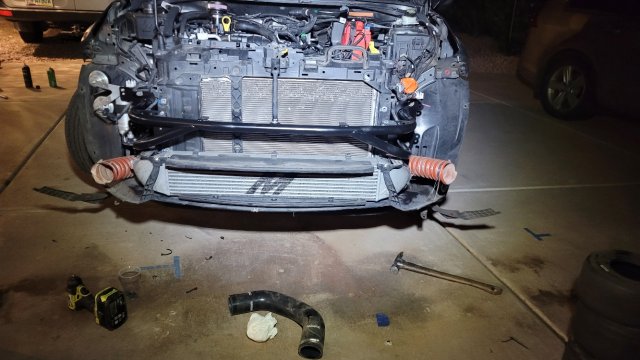

We are looking around the car for areas to improve and are starting with moving as much weight as possible from front to back. We installed the TB Performance front crash bar and gutted the factory headlights.
Crash bar was 13.8lb and the stock crash reinforcement was 22.3lb, so around 8lb savings, and the headlights were 5.4lb each, and gutted they are down to 1.9lb each, so total savings of 7lb. That 17lb will be moved to the rear, so its actually quite significant, at a 34lb shift from F to R. Thats taking us from ~60.5/39.5 to ~59.3/40.7 F/R split.
Also, it means that the headlights at ~220$ for chinese replacements, are way better $/lb than the crashbar at around 420$.
