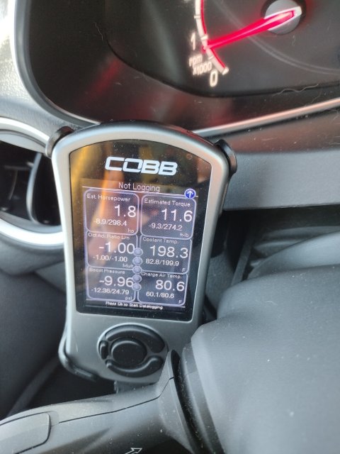

I think prior to the flush my clutch must have been slipping. I just did a playful run with a focus RS and my fiesta felt strong. I know the Cobb hp estimate can't be trusted but it spit out some nice numbers. Flush your clutch and breaks!!!!!! Best mod so far!!! Lol
