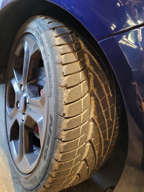

What are people doing to conserve tires and brakes at hpde events? Went through both in 3 20 minute sessions.
Setup:
Stoptech slotted rotors
Hawk hp plus pads
Nitto neo gen tires
From what I have read running higher pressure in tires might help or changing to a track focused tire. Also saw post on brake cooling ducts. Any other recommendations would be appreciated. Thanks. 20210619_090352.jpg +PL1_7996.jpg

M + S all seasons are not going to fare very well at the track. I'm lucky because I can run summers year-round. If you plan on continuing with HPDE, you may need to consider buying a second set of wheels/tires.
I recently added Boomba brake deflectors to my setup, and they definitely helped. Very easy to install.

Definitely a track specific tire. Max/Ultra summer tire. A/S tires just aren't ideal. That said, check your pressures. Run a warm-up lap and then 2-3 hot laps and check your pressures. I'll easily increase pressures by 5 psi and 10 on a hot day. You need to manage pressure and temps as much as possible.
Brakes are dependent on the track. I run Stop Tech rotors and Mountune Track pads with Motul RBF660, stainless lines, and Boomba deflectors.
It's also a giant rabbit hole that you're about to start heading down. You'll swap tires and run faster laps. Brakes will take more abuse and so will cooling. You'll solve one thing that's holding you back and that will result in a new issue.
^^^This.
Albeit, because of their tread pattern and 280 tread wear compounding, the Neo Gens may seem like an acceptable track donut (especially when compared to other much more 'tready', and 400 tread wear and above all seasons which some erroneously attempt to use for open tracking), but they are STILL an all season tire. [wink]
As good as they are on the street (I have them in 205/50-16s), I always think that I will tear them up driving them hard in the summer heat on back roads, let alone on a track or autocross course.
