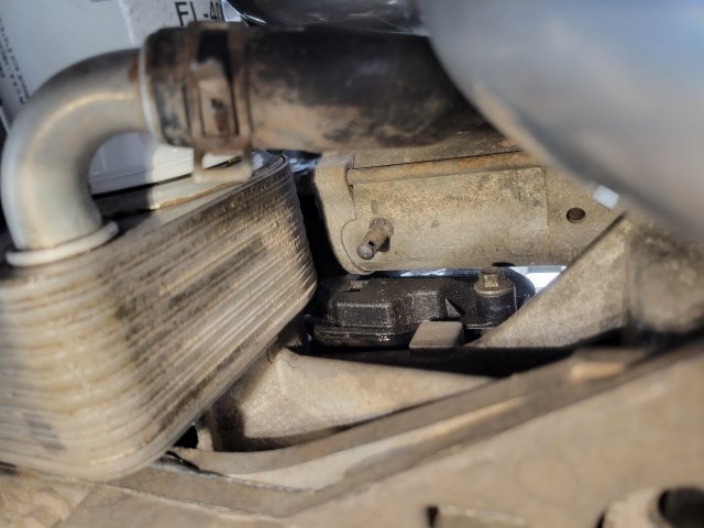

It looks like I'm blowing oil out of the bottom of the factory air/oil separator. 97k miles, catch can is installed but on the other line. See picture attached. Would love opinions here hopefully that's all it is. Tagging @Woods247

That’s the first time I’ve seen this. Can you see exactly where it’s coming from?
