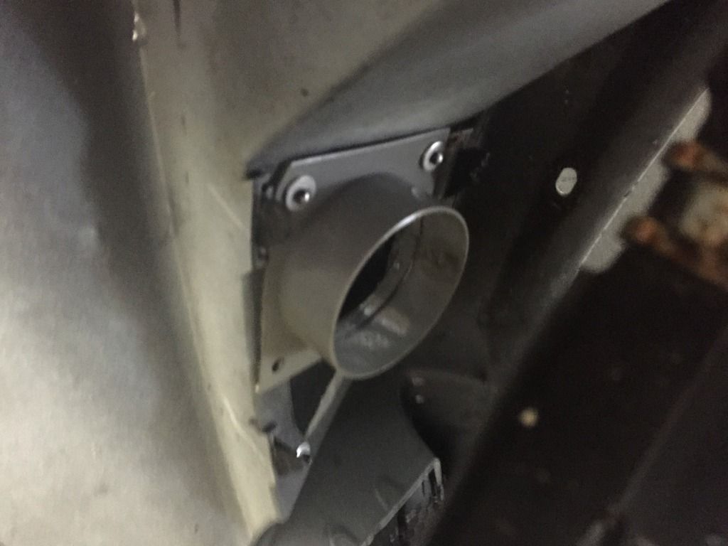

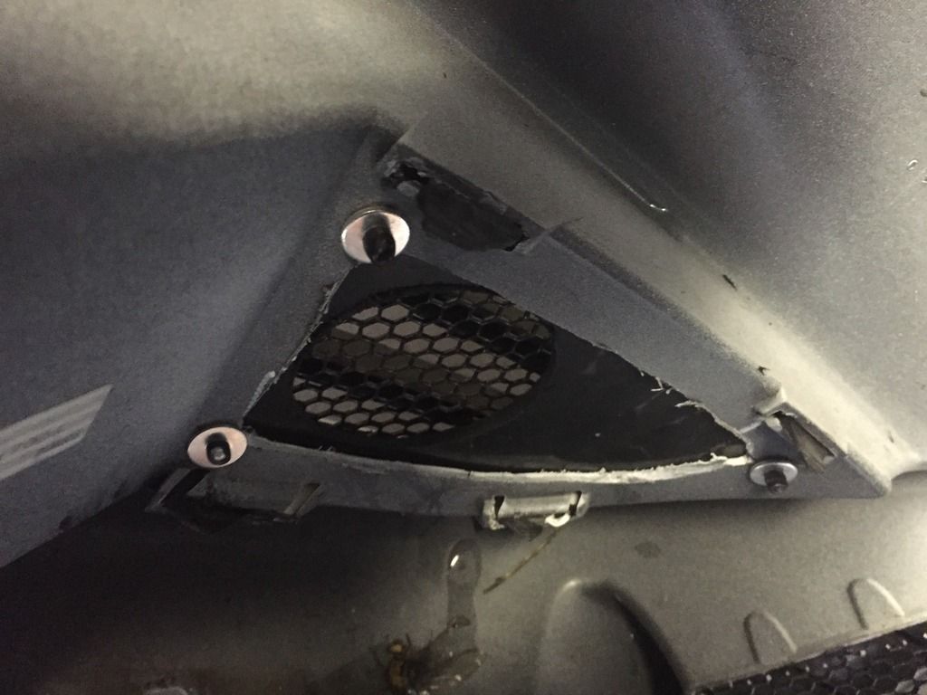

I removed the fog light facias, cut out the recessed black plastic "fake inlets" leaving the ribs, attached aluminum mesh vent cover and 2" round hose leads to back sides.
And then realized the windshield washer bottle was in the way of the left side hose to front brake. Duh.
I believe I posted pics last year, maybe on exterior mods thread, computer I am on today does not have all my pic files.
I recently found OEM washer bottle with pump on Amazon about $40, so I could try cutting one up to make room for air hose. But first I am going to use some of that temp paint to see just how hot brakes actually get tracking. Should have data end of month, ordered paint and caliper strips yesterday.

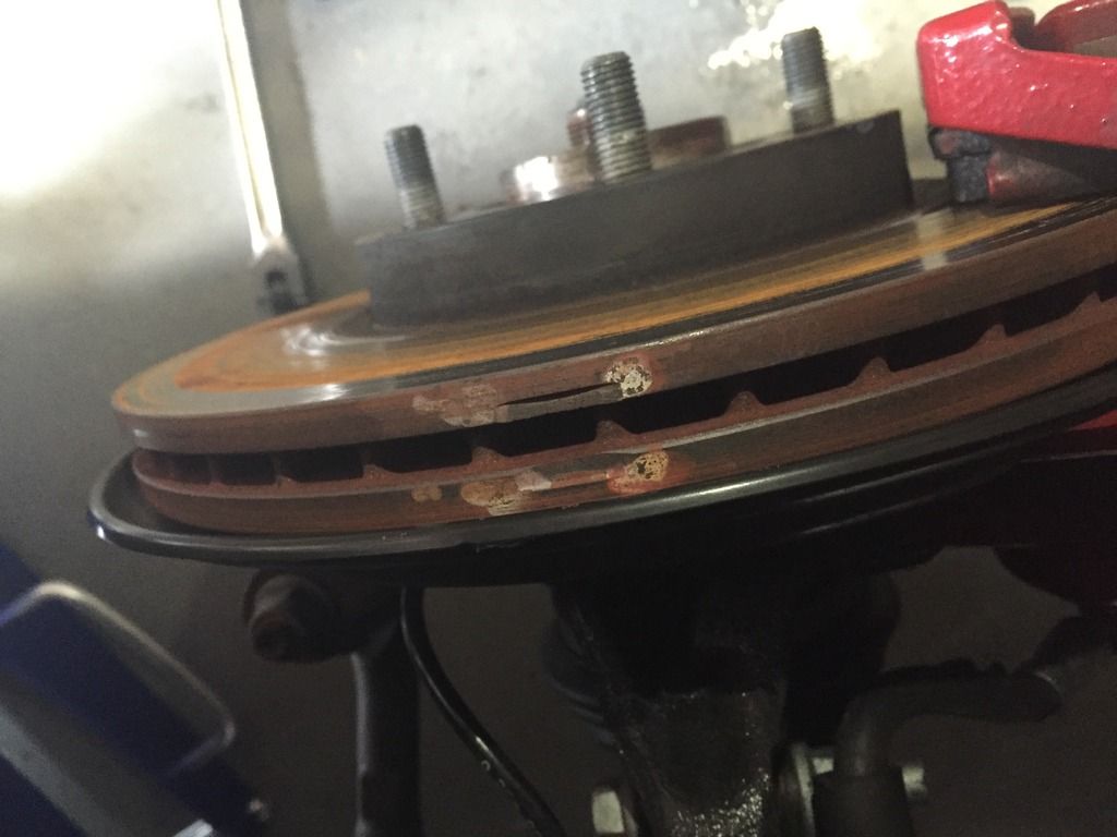

Josier posted cracked rotor with this setup. Not that a cracked rotor proves anything one way or the other. Without some idea of actual temps we are all guessing.

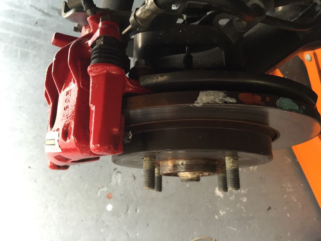

Front and rear caliper paints, blue 750 F, tan 1000 F, gray 1250 F
Post Sebring, fronts. Right front appears to have run hotter than left, maybe because track is clockwise, maybe because hairpin is a right hand entry with long right exit under full power, if nannies intervened to make brake temps higher, this would be the place. Need more information.
Rears did not hit 750F either side.
Front calipers matched temps, Rears calipers did not exceed minimum temp. I am hating windows 10 already.
Next test strips right over pistons, maybe get closer to actual brake fluid temps.

Back to what started this experiment, I opened up the fog light facias for brake cooling and realized washer bottle blocked drivers side, so right side has duct connection, left side leads to Mountune air box lower intake. Pics from inside nose while I had it off for repairs Sunday.
It seems reasonable to conclude that right side vent does not appreciably cool front brake at track without a hose directing air into hub. Left side likely does not do anything for left front brake, and I cannot tell that intake temps are any lower with or without this mod, intercooler has too big an effect in CAT vs outside air vs extra air source w/Mountune box.
But I still like the open screened and functional-looking vents even if they do not accomplish much so far, they look cool from outside.

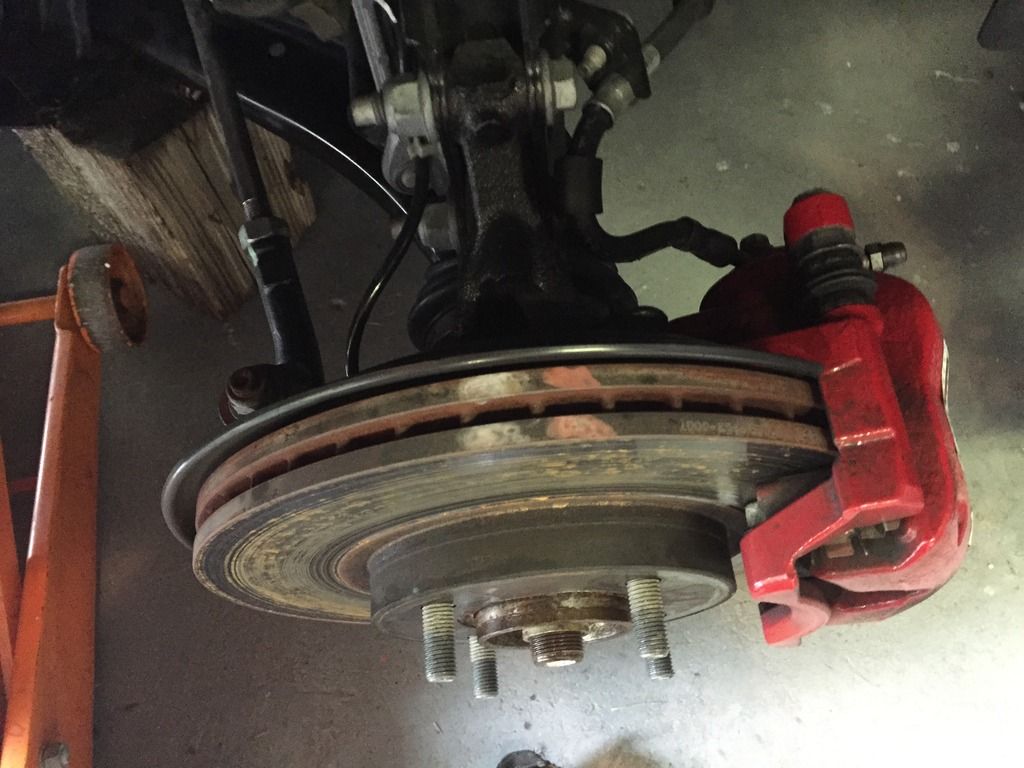

Update from PBIR 9/5. Similar weather as Sebring. Hot, high 80's.
Off with Hawks, on with OEM front pads. Front discs hit 1000 F inside face and below 1000F outside face, both sides. Rears all below 750F.
Front calipers hit over 250F and under 290 F both sides, stickers right over pistons.
Obviously different track, but max braking actually a little more at PBIR turn 9 than hairpin at Sebring, Harry's LT shows delta 70 mph vs 65 mph at my best pace.
Only mod is pad change. OEM pads run a little cooler than the Hawks? That is what these data indicate. They wear better and stop better, no fade.
I am still on BFG S-Comp2, stickier tires should present greater heat. 10,000 street miles and 7 track days, still plenty of tread.
