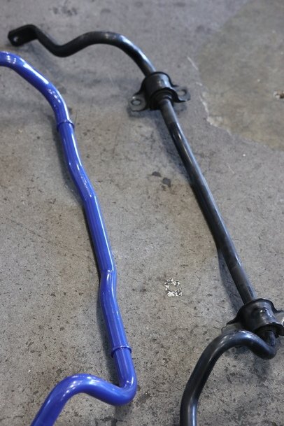

Glad you reopened this. Although we drive the Transit Connects we had and still have a small amount of clunking. This increase soon after hitting something in the road around a work zone in Suffolk Va. Some say it was a latter but I believe differently. Anyway.. ever since hit that whatever, the front passenger side has a very distinct cluck, but only when driving over potholes.. I was able to correct other squeaks and clunks when we upgraded the entire front end of the vna costing us 4K. With each repair or replacement we imlinated one clunk or one squeak. Turns out that the whiteline end links were too short. This kept the sway bar in an upright or near upright position.. more like +20°. What one was hearing is that the sway being upand without any more up travel was hitting the subframe or pinch seam long the engine bay and wheel well. Systematically we got rid of each squeak and clunk and with one solid clunk left.. it would seem that what's left to replace is the barings. The shop tells me that if it was the baring, the wheel speed sensor would go off.. but we've not had any of this.
You can read about what it took and how much it cost to isolate these squeaks and clunks.
https://medium.com/@FlordPerformanc...he-van-s-entire-front-suspension-c8d46d9d1c03
Even with replacing nearly everything on the front end of the van, we're left with the wheel bearings.. and there will come a day when we replace them. So till then and note to others:
  • Check the angle of your sway bar
  • Check for marks on the sway bar
  • Check the sway bar bushings
  • Check misaligned control arms. if the control arms were installed while the car was on a standard lift, this would allow the the arms to droop and then the shop would tighten them down. This is NOT how the arms are to be installed. You need a full alignment lift to fit to correctly set the control arms in a level position.
  • Check for marks on the inner wheel well as the end links could be hitting in that area as shown in my blog. which means the stand off of the links if pushing the ball joint out away from the strut. then hitting the inner wheel well. The only way to correct this is to find shallower links with less of a stand off or spacer milled into the ball joint stud/treads.

Just to confirm others comments about the sway bar making contact with the subframe is true.. but is not what our issues is. check the sway bar for any maring around the areas where the bars looks to may have come in contact with the subframe or pinch seams. Before anyone asks, Yes the clunk was there even before we installed the new bushing or sway bar.. Also, there are videos showing that the sway bars can shift left or right which can make a clunk sound. if that's the case, then the bushes will need to be replaced and most sway bar have lateral rings designed into the bar, if they don't then you make need lateral locks.
Is it possible it could be due to a bad transmission mount?
We've order 2 of the 4 mounts to address this possible issue. Till then, yes the clunk is still there which developed soon after hitting something in the road back in Sept. We've spent nearly 7K replacing nearly all of the front end suspension compounds and the clunk is still there but only when we hit a deep bump on the up travel and not the down travel. This seem to suggest that the newly install sway bar with new grease poly bushings may need some fine tune adjustments.. the sway bar has extra end link mount holes which could angle the sway higher or lower. just a few test will need to be checked. I'll have the shop make the link adjustment when we go in for an oil change.
Just so others know and unless you have poly mounts, the average lifespan of a rubber engine or trans moutnis is 5-7 years. Things like deep hits or extreme gravel roads etc can cause these mounts to unseat as most are not of a solid design. So suspect that either the trans mount or even one of the engine mounts is allowing for this clunk.
