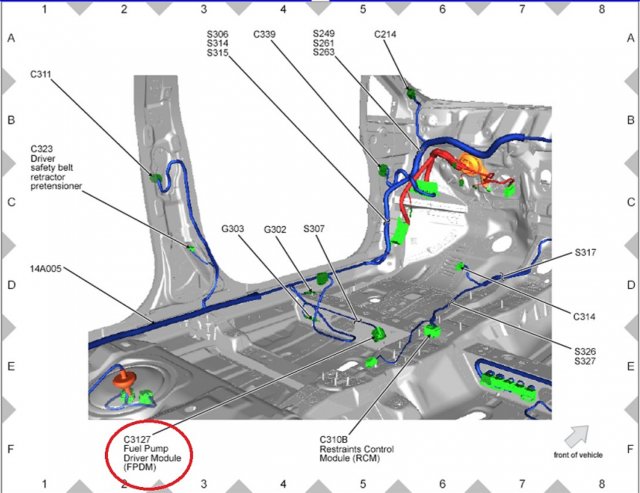

Hi all,
Does anyone with a Mk7 Euro Fiesta ST know where the FPDM is located?
I've had a feel around the area in the picture above (under the passenger seat on a RHD car), there is a hole in the carpet for the seat airbag harness) and I couldn't feel anything attached to that section of floor. No wire loom or anything.
I've also looked under the rear seat too and didn't see it. Hoping someone knows where it is.

Hi @lordsnipe I know this is a bit late, just seen it. On my 2017 st, it is located in the left hand rear of the boot (trunk), behind the carpet. you need to remove the plastic slam panel, then slide the carpet out from the rubber door seal. Hope this helps. (y)
