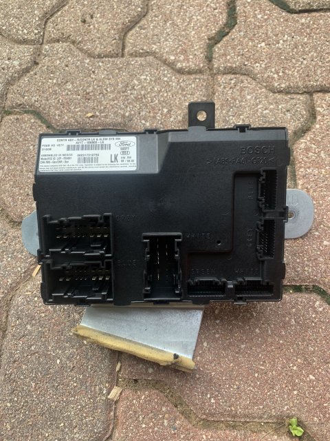

Hey so, for a while now I’ve had some mysterious car symptoms like when I roll up my window it rejects auto up randomly even after reprogramming the window heights. I’ve had the second push lock from FOB stop chirping, and brake lights slightly flickering (this could just be junk bulb) also, recently I began hearing an audible and consistently timed ticking/clicking aprox every 10 seconds. This ticking/clicking was coming from the behind glovebox fuse box area. I decided to check out all of the relays with the ol screwdriver to the ear stethoscope style isolation. None of the relays were clicking in the fuse panel. Although, I put the screw driver to this box, later to be identified as the BCM/GEM. I believe that there are relays inside this unit because the clicking certainly sounds exactly like a relay. Anyways, can anyone assure me that replacing this unit will resolve the issues? Is there a proper way to diagnose this unit? I will order a FORSCAN switching cable and purchase FORSCAN. I believe I can self read the vehicles code and save the learned program for this module via FORSCAN then just replace the BCM and reprogram based off of saved programming from existing unit.... is this correct? @TDavis or another FORD tech and/or anyone else able to set me up with some more solid info?

Could very well be a bad BCM (if it's the BCM you're talking about, has a bunch of fuses on it; what you have pictured is the alarm module), which requires dealer-level programming since the new one will need to register with all the other modules on the CAN network as well as your key fobs. Without being hands-on though, hard to say.
Yeah for sure it’s that unit that’s clicking inside and my alarm chirp doesn’t work... all adds up seems like. I’m pretty sure I can download it’s programming then reinstall the code via FORSCAN. I don’t have the money to do any of this yet so will prob do sometime over the winter while it’s parked for the season.
