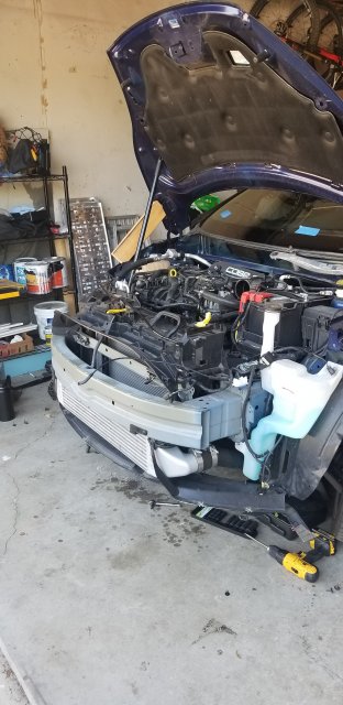

Does the tow hook mount to the bumper support? If you need to attach it without mangling the bumper you will probably need to take it off, though at this point I can get the bumper off in less than 30 minutes so its not that big of a deal.
I wish I had started with a radiator upgrade, the stock radiator is fine when nothing is done to the car, but after doing full bolt ons the car would overheat and go into limp mode any time the sun was out pretty much.
I attached a pic of the car without the front bumper, my guess is the tow hook will mount to the top or bottom of that bumper support, mainly because I dont see any other place you could put it.

Yup it mounts to the bumper support, it mounts to that and has a threaded portion that sits in the back after you drill holes through the support.
I’m modifying any part of the car to add power so I won’t have as big of an issue but I still need to do these mods for the track for sure
