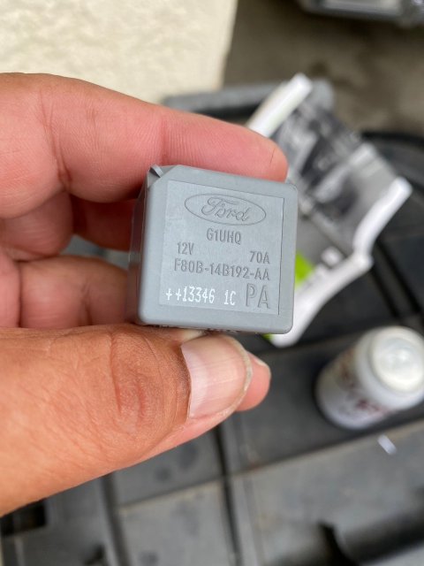

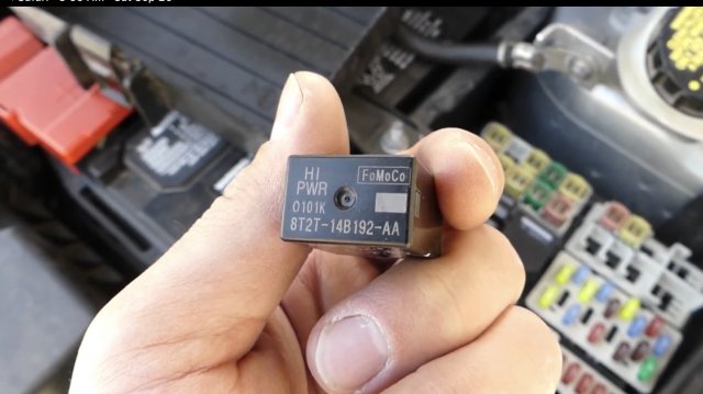

Ok .... the UPDATE .
Not the relays , not fuses . It was the PCM that went south. BUT was blessed overall in this situation. My Ford dealer ( I use for my fleet vehicles) took possession of car and kept for a few days before letting me know what happened. But the blessing came in form of a new PCM at “ no charge “ and at no installation cost either.
I was told item has a lifetime replacement. Now I’m happy as shit , car is back and ready for driving.
