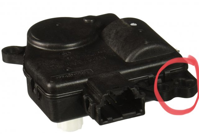

I just did the passenger side a couple months ago. I had to cut the inside of the tab circled to get it to fit on the car. It didn’t match the old part even though it was the same part number. Has been working fine though since.
