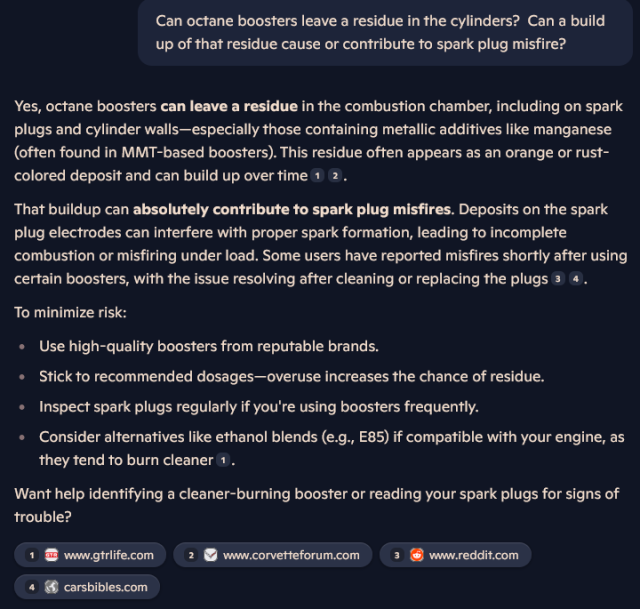

Octane boosters can leave a residue in the cylinders; that eventually build up and contribute to issues.
Running the engine hotter with a fresh set of plugs can help cleanup the cylinders.
