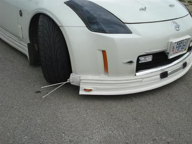

learn to park or get curb feelers, they are making a comeback, lol
