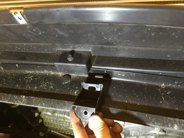

I had to make a bracket for mine. I didn’t take any photos of it since I was in a mad dash to to the install before the wife figured out what I was doing.
This picture isn’t that much help, but it shows the OEM plastic bracket that was trying to occupy the same space as the V3. I bent up some stainless, drilled a couple holes and transferred the clip nut.
