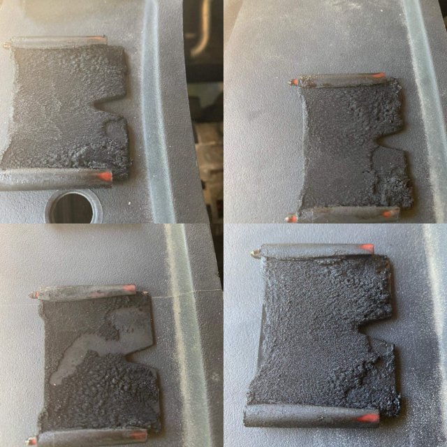

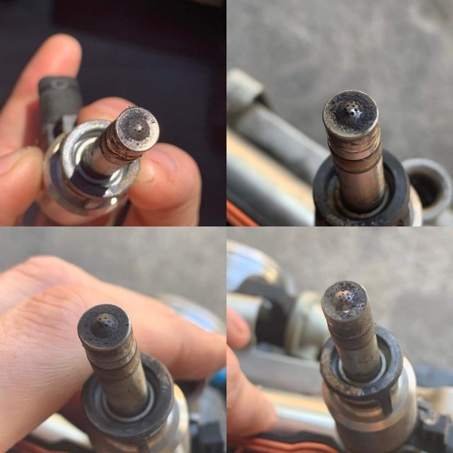

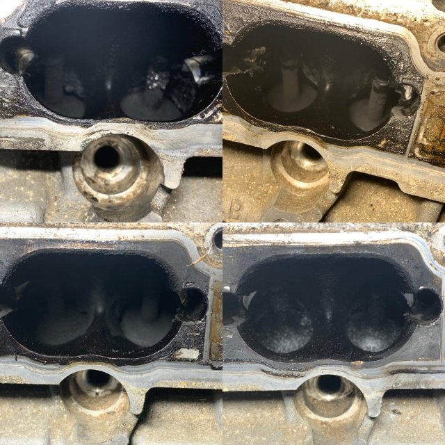

Pics incoming of the horror show. This car was NOT maintained well. And i dont think theve ever done any carbon cleaning. New injectors going on as well. I hope this solves the misfire problem for a long time.

received_2794700590816871.jpeg received_780199279382316.jpeg received_309079847104328.jpeg
The carbon was easily 1/8 thick on the tumble flaps for a couple of the cylinders. We had to really scrub even with the CRC.

I realize that our whole system is NOT an early VDub D.I. level injection setup.
But after seeing those injectors/valves/ports above, if it were not for the OBD2 plug-in inspection we must go through every year here, it makes me want to get an auxiliary 4 port injection setup and an integrated stand alone ECM to properly run/coordinate the whole thing. [wink]
