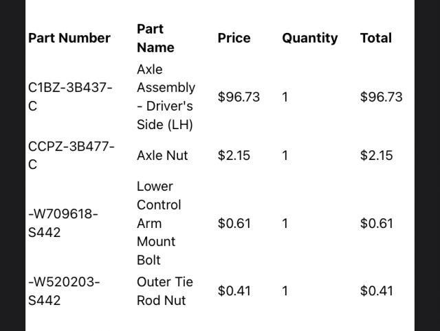

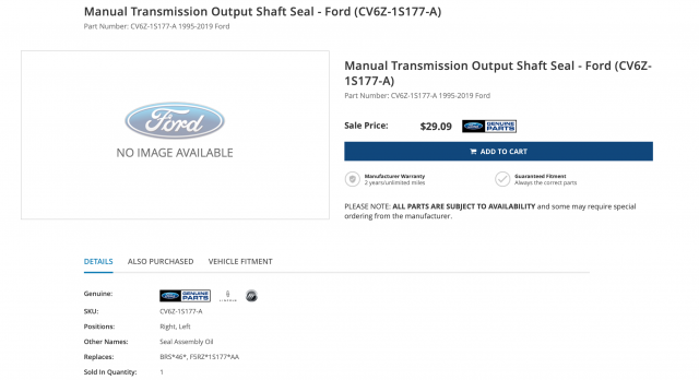

Hi guys,
Thanks for all the helpful tips!
I am sitting on the following OEM parts and 2 liters of Ravenol MTF-2 75w-80 for the transmission drain and fill.
I just ordered the Output Shaft Seal (part# CV6Z-1S177-A) as a precaution from a local Ford dealer.
Thanks again!!!

Hi guys,
Thanks again!!!
I will suggest tools also so you don't score/ Mar the inside of the Transmission edge pulling the seal with incorrect tool.
https://hftools.com/app63039
And a seal driver to correctly and evenly install the new seal if you need to replace
https://hftools.com/app63261
