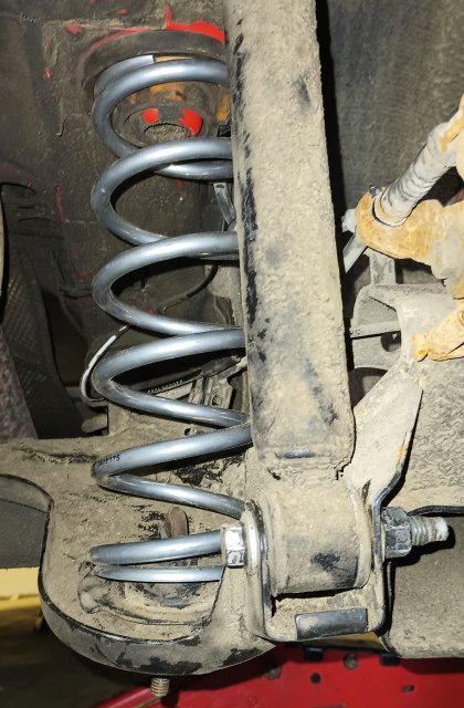

I installed rear Mini Cooper S R56 springs in the front which I picked up on Amazon. This site has a great searchable spring database. The url looks sketchy, but it was a top hit on Google: https://size.name/en/catalog/pruzhiny
The pig tail end was a bit tighter than the tool suggested. I ended up having to cut 1/3 of a a turn off, which didn't impact the height. I put the spring in a bucket of water and used an angle grinder.
For the rear I picked up a set of essentially unused 2.5x10" 175lbs coilover springs. I used an exhaust clamp to hold the spring in place at full droop. See the attached picture.
For some reason the rear of the car is sitting about 1" higher than the front. I'm not sure what to do about that? The front is roughly at the same height as it was with the OEM springs.
I haven't had a chance to drive it with much aggression, but I didn't notice anything negative so far.

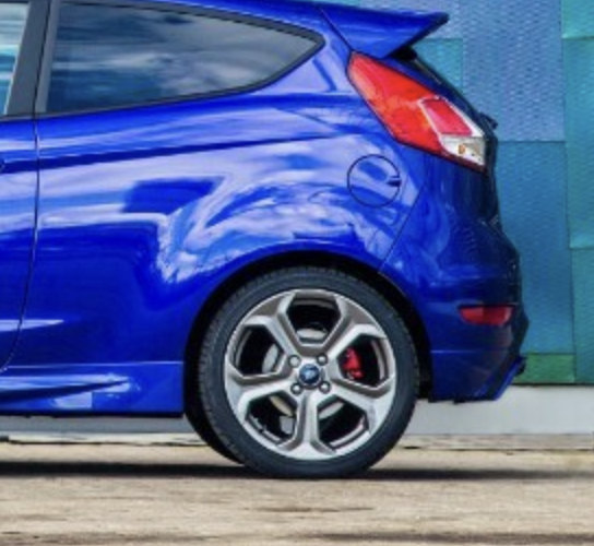

#39
Here's a pic.
I'm a bit concerned by the front ride height. Seems like it might be getting lower. Left side may be slightly lower than the right. I wonder if the cheap springs I used in the front aren't very good.
The rear seems a bit higher than OEM. I'm tempted to cut a bit of height out...

#40
Rear actually looks around OEM height to me. One thing to consider is that stock springs do sag, for instance when I was on stock springs around 60k miles, my "OEM height" was about half an inch lower than right out of the factory.
The best way is to check ride height according to the shop manual.
OEM height (not my car)
