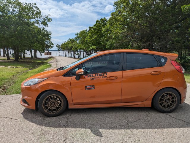

+35 but I use a 10mm spacer up front so effectively 25 offset, 25 will be more likely to rub depending on tire size and alignment and you will notice more torque steer/tramlining on the street.

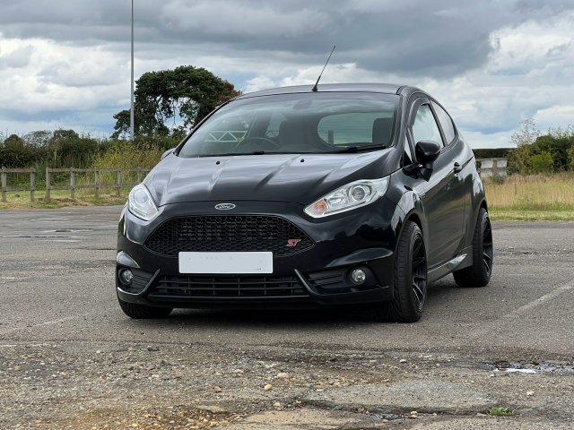

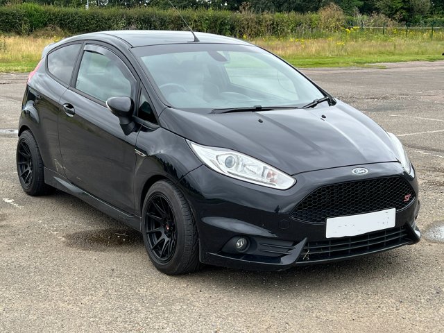

I went with JR11 15x8 et25 in the end and i think they really suit the car. They sit very slightly out from the body but actually prefer that, adds to the stance and not experienced any rubbing as of yet.
