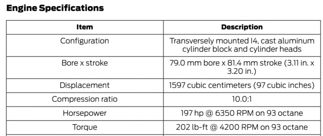

It's clear that it's safe to run the car on 87 octane, as the comments in this thread and the information from Ford linked above make clear. However, I just can't understand why anyone would choose to do this, I want the car to be able to make the maximum power that it's capable of, and it's also clear that running the car on 87 octane prevents this from happening.
If you're just daily driving it it may not make much difference, but what about that fun time when you can get on it, or when you're merging on to an interstate and it helps to have maximum power? I just don't think it's worth handicapping the power of the car to save $5 or $6 per tank full, but obviously everybody gets to make their own choice here.
I do think it's misleading the way Ford presents their different octane recommendations in different parts of the manual. In the section of the manual referenced above it clearly recommends 87 octane but in a separate section where it lists the power specifications of the car, it clearly notes that that power is only made on 93 octane, screenshot below.
I was looking for that. For whatever reason the search for the word "octane" or number "93" did not land on this.
