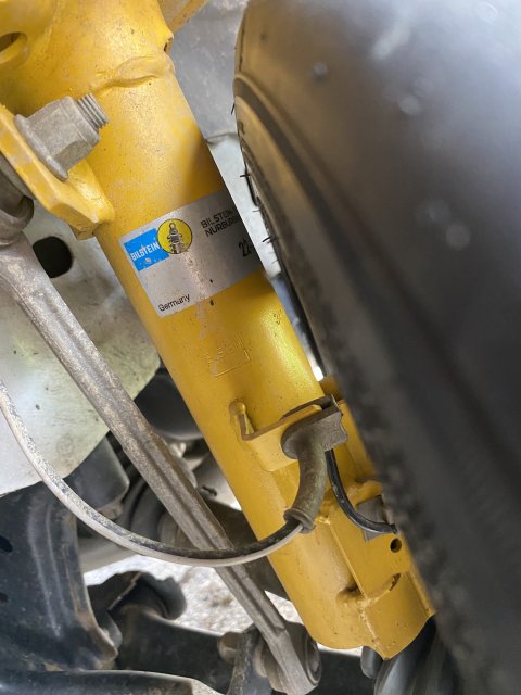

Did I ever send you those photos I took? I attached one of them here.
The Dekagram is ET40mm and there is probably 3-5mm of clearance with the Dunlop 225/45R16. I wouldn't want to go any higher for fear of rubbing on the dampers. I would honestly prefer to go out another 5mm to an ET35 to be safe. But I also run some camber up front (I think -2 or -2.5 degrees) so that helps mitigate rub. Not sure about poke..

In any case, THANKS, as I was thinking about going to a 43-45 ET on a set of Braids which they drill, and 'mill'(?? for any custom ET) to order. [thumb]
