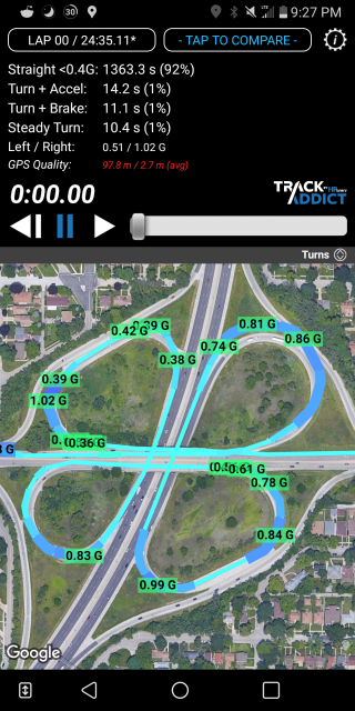

Thanks! I didn’t drive very long on the 17s but I prefer the 16s. I never pushed the 17s too hard since I wasn’t as familiar with the car yet but she handles extremely well with the 16s. And they’re a lot lighter so the car feels noticeably faster.
If you ever decide to record that data, I use Track Addict in conjunction with a GPS receiver.

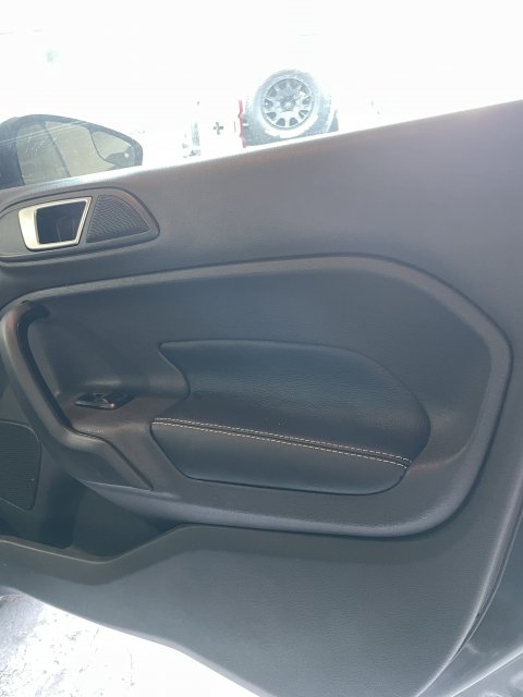

Decided to do the door card armrests today. It’s a LOT of work compared to the center console & shift boot, and takes some patience to get it right, but I’m happy with the results.

Decided to do the door card armrests today. It’s a LOT of work compared the center console & shift boot, and takes some patience to get it right, but I’m happy with the results. View attachment 40432
That looks sooo good. I went ahead and ordered today (shift boot, arm rest, front/rear door arm rest) after seeing your install. Did you use spray adhesive to mount the door arm rest?
I used 3M heavy duty spray adhesive. I had to trim the edges in a few spots to get them to fit better. Go slowly and keep test fitting to make sure you get a good fit. The instructions on their site say to grind off the melted plastic posts, I found it easier to use a sharp utility blade and carefully slice them off. There are a couple that do need to be ground off though since you can’t get a blade on them. Getting the old foam off is also tricky. Once you get the majority of the foam off by hand, I found the best tool again was a sharp utility blade and just carefully but firmly drag it across the foam to scrape it off.
EDIT: Another note about removing the old foam, be careful not to remove the denser black foam underneath the grey stuff. To get the majority of the grey foam off, use your fingers to tightly roll it away from the cardboard. The tighter you can keep it while rolling, the more foam you’ll get off on the first pass. It will save time scraping off the last bit of foam with the blade.
