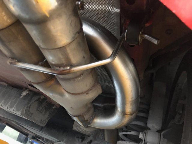

Thanks a lot ,the drone is driving me crazy at 3200 rpm. I'm gonna look in amazon for the vibrant, I want to archive the drone reduction you got in the second video.
Thanks again.

I'm just trying to clarify - it's not the vibrant that reduced the drone, even after the vibrant I had the boomy peaking at 3200RPM, what fixed the drone was the loop of pipe that looks like a trombone. Let me know what exhaust you have and I can take a look to see if you're likely to have enough room to do the quarter wave tube. The Vibrant only mitigates the high frequencies (some crackling, the high pitched turbine noise). The deep noise (at ~3200rpm) has a wave length of 10.5 *feet* so the vibrant is way too short. That's why I math-nerded it out and came up with the looped section. You can copy the exact same length I reference in my initial post, and show an exhaust shop the picture of how mine is looped, but it's only going to work if you have no rear muffler or a really tiny one (like the vibrant). I bought an MBRP to test, it's the drone-iest exhaust I have ever seen, and just the looped portion completely resolved the drone and quieted it down.

Right on. If that deep pressure feeling around 3200 gets to you, this thread is exactly to target that frequency, around 107hz.
For me, adding the vibrant just made the 107hz "crush" more obvious, but I am extremely sound sensitive. I even wear earplugs at the movies (you can still hear the movie fine, just less loud - and you can't hear people talk or babies crying!)

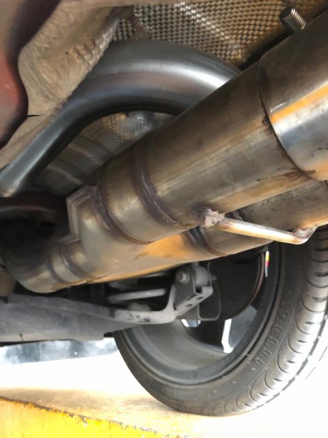

If you decide to keep it, you can use the same expansion tube design I used (quarter wave resonator) to totally kill that 3200rpm drone. That's literally what I built that rear loop for - just find an exhaust shop that can fit a loop in the rear muffler cavity (if the MAPerformance exhaust leaves enough room) of the appropriate size and you should be drone-free almost instantly. Just find the RPM drone range and target the middle of it, or target the rpm where the drone is the absolute worst, and work from there.

The current is just an MBRP aluminized with the custom rear resonator - I just included the pic so you could show a shop what you wanted, but if you have what I have (mbrp) then the length I used should work for you. It needs to be teed in at a 90 degree angle to work, a forward or rearward lean to the angle will not work.
Noted. Any performance loss with the resonator or would it be a source of restriction if i go big turbo down the line? Not sure if I have the stainless or aluminized since I bought the car with exhaust.

As long as it’s a 90 degree tee, no - it’s leveraging the same effect as blowing across a bottle to make the hoooooooo noise. Once the chamber is pressurized there’s no turbulence because there’s no flow. The catch is the quality of the welding - if they booger a chunk of weld into the pipe it could add turbulence, but I’m guessing it would take an *extremely* bad weld to make a difference. Remember if your exhaust is stainless to get stainless resonator as well. My
Mbrp is aluminized but I had the chamber made in stainless so I could reuse it if I want.
Hey there, been reading all this post and just installed one for the MBRP in T409, yes it droned a lot. I used the same 107Hz without any calculations to see how it would perform. It removed lots of drone but know I did the "maths" and found that the real frequency is at about 85Hz, same as the phone app says. I will add the remaining 8" if possible for my specific application. Thanks a lot for your guidance this really does make a significant improvement.
