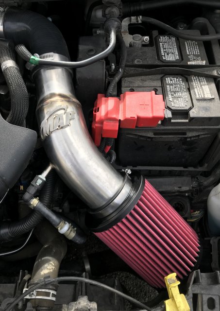

I'm loving my MAPerformance short ram intake. I've swapped over to an AEM dry filter and with the Mountune crossover I'm super happy with it all. It will heatsoak at a standstill noticeably quicker than the factory airbox but once you're moving it's great. It does sound ridiculously good if you want all kinds of intake / turbo drama. Running a modified 16+ EVAP harness which should be functionally the same as just using the earlier one

To put it simply, the 2015 harness has a single termintion going back into the intake where the 16+ has two. I just literally cut the section out of my EVAP harness before it breaks into those two lines and clamped in a piece of rubber tubing with the proper termination for the intake. Just works. I should've just remembered and bought the 15 harness though since I was already getting a new one. Just slipped my mind.
