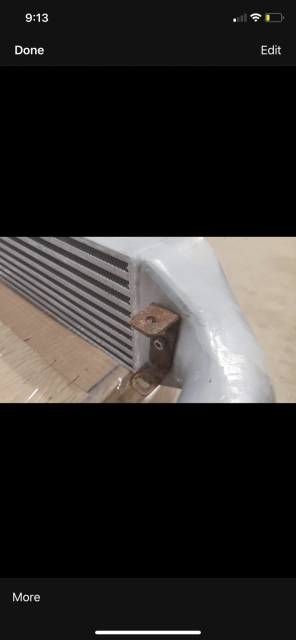

Intercooler help

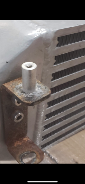

That peg is part of what keeps the intercooler from moving around and I would feel that you would really want it. Not sure on a good long term simple fix. Its possible that Ron/Whoosh could sell you something. I would call or email him for a quick response. Judging by the photos, the V3 has removable brackets so should be quick to swap it out.

Is that other bracket threaded? If so you can buy another one at a local hardware store. They are called bolt extenders. Just bring the other one with. I've used them to extend my batter studs to accommodate my group 48 battery I got to fit into my factory tray* with a slight modification to the battery tray..
