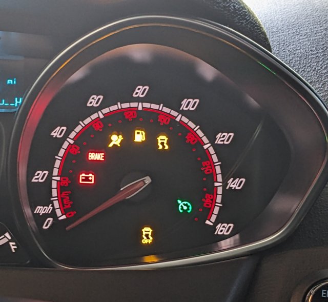

#40
For those doing the battery monitoring system reset, once you've done it the battery / charging system warning light on the dash is supposed to blink and then go out. Here's a picture of it so people will know where it is and what it looks like. These warning lights come on briefly on startup and then turn off after about a second.
