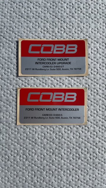

I have no problem supporting COBB for their efforts and recently purchased their intercooler. With the intercooler were these CARB EO decals, which I appreciate. As a lifelong resident of California these decals and CARB EO numbers are respected at smog inspection stations in CA should they be deemed necessary during an inspection. It’s the smog techs assurance that the component in question has passed CARB.
CARB compliant parts try to benefit the health and environment for many and more importantly future generations. As a lifelong car enthusiast I also appreciate nature, the ocean, wildlife, good food, clean air and water.

It is nice that Cobb got the CARB approvals on the parts that, in all reality, should not affect emissions - intake, intercooler, and a tune that stays within the boundaries of what will pass. I work with a number of companies that are in the "We touch the ECU" business, and not all of them have taken the steps to support platforms that are no longer available in the U.S. Some have simply abandoned the California market.
In my last job, we made data recording systems for race cars, and some of our products plugged into the ECU, so we did our due diligence as well. If you make a product that should not cause the CARB and AQMD nannies to clutch their pearls, it's not hard, but it is time consuming and does cost money to get EO approvals. SEMA is a big help - they have a full facility at their headquarters here in CA where companies can bring their products, hook them up to cars, test, and tweak to make sure that they will comply with CARB regulations. It's likely that Cobb paid the fees for CARB compliance and certification testing, and while they were at it and had the testing equipment at hand, tested and certified as many easy applications as they could to knock out a bunch of EOs. That's what we did.
However, one thing that I wish they would do is make the decals available for people who don't have the original sales receipt for the products. Looking at other companies that provide replacement decals for CARB products, some require photos of the product, the VIN of the car they are attached to, and a signature on an affidavit that they're not lying about it. Yeah, I'll go get my smog check armed with the printout of the EO paperwork, which Cobb provides on their website. And yeah, if none of the certifications occurred, I was ready to throw my stock intake back on to pass the visual inspection, and reflash my car back to stock.
Maybe with a stage system that involves multiple components and a tune, there are too many variables that just promising that I'm telling the truth about it won't allow them to send me a sticker. I dunno.
